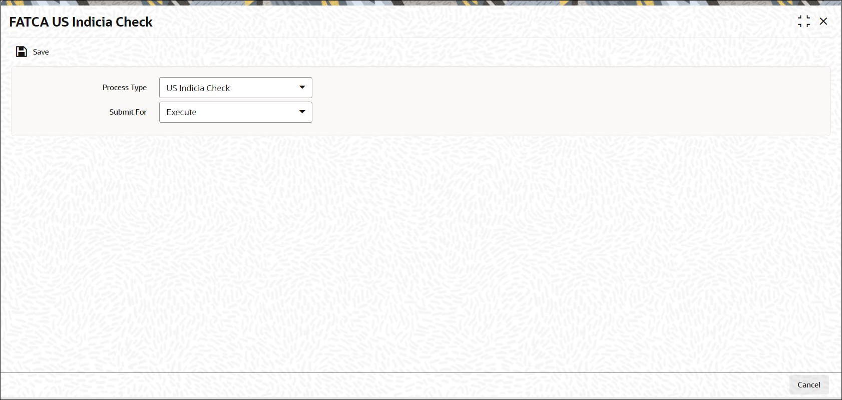

  1. On Home screen, type STDFATCL in the text box, and click Next.
    The FATCA US Indicia Check screen is displayed.
    Figure 1-18 FATCA US Indicia Check
  2. On FATCA US Indicia Check, click New to enter the details.
    Table 1-30 FATCA US Indicia Check - Field Description
    Field Description
    Process Type Optional
    Specify the process type from the drop-down list. The list displays the following values:
    • US Indicia Check
    • De Minimis Check
    • De Minimis Yearly Check
    Submit For Optional
    Select the submit option from the drop-down list. The list displays the following values:
    • Process
    • Execute
