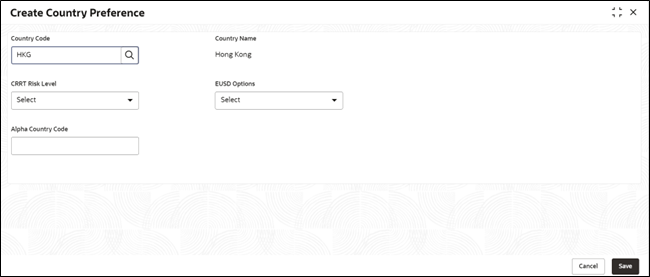

  1. Access the Create Country Preference screen by typing Create Country Preference in the Menu Item Search option or navigating manually from Menu option.
    Navigate to the Menu, select Investor Servicing and click Create Country Preference within Country Preference.
    The Create Country Preference screen is displayed.
    Figure 1-1 Create Country Preference
  2. On the Create Country Preference screen, specify the fields.
    Table 1-1 Create Country Preference - Field Description
    Field Description
    Country Code
    Alphanumeric; 3 Characters; Mandatory
    Select the country for which you wish to define country preferences.
    CRRT Risk Level
    Optional
    Select the CRRT, the Country Reputation Risk Table associated with the country from the drop-down list. The reputation risk level may either be High or Low.
    High implies that it is a high-risk country while Low indicates cautionary risk country. While creating a unit holder, if the unit holder domicile country is listed in the CRRT list, then system throws up an error depending on the country risk level.
    EUSD Options
    Optional
    You need to associate a (European Union Savings Directive (EUSD) option with each country. Based upon unit holder’s country of domicile, the corresponding EUSD option of that country will get defaulted during unit holder creation.
    The list displays the following values:
    • With Holding Tax
    • Exchange of Information
    By default, no option will be selected. If no option is selected the system will consider that the EUSD is not applicable, and the system will not track the average cost as required for EUSD. If any of the option is selected, then the system will consider that the EUSD is applicable. The EUSD option at transaction level will be defaulted from the unit holder’s EUSD Option. You can also modify the EUSD option at transaction level. The transaction level option will be taken as the EUSD option. The following EUSD Options would be available at transaction level.
    • With Holding Tax (WHT) - EUSD tax is computed and deducted
    • Exchange of Information (EOI) - EUSD tax is computed but not deducted
    • Tax Certificate (TCE) - EUSD tax is computed but not deducted
    For all the above three options, the system will calculate the EUSD tax. However, if you select With Holding Tax, the system will deduct it from the settlement amount.
    Alpha Country Code
    Alphanumeric; 2 Characters; Optional
    Mention the country code in ISO alpha-2 format.
