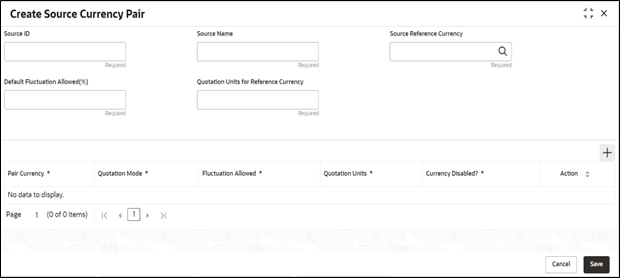

  1. Access the Create Source Currency Pair screen by typing View Source Currency Pair in the Menu Item Search option or navigating manually from Menu option.
    Navigate to the Menu, select Investor Servicing and click Create Source Currency Pair within Source Currency Pair.
    The Create Source Currency Pair screen is displayed.
    Figure 4-1 Create Source Currency Pair
  2. On the Create Source Currency Pair screen, specify the fields.
    Table 4-1 Create Source Currency Pair - Field Description
    Field Description
    Source ID Alphanumeric; 60 Characters; Mandatory
    Specify the name of the Source that is to be maintained.
    Source Reference Currency Alphanumeric;3 Characters; Optional
    Select the currency that is to be designated as the reference currency for this source. This is the currency in which the rates are to be maintained for the other currencies. An In Currency can be designated as the Reference Currency for a Source only if the validity period (transition period) for the currency has not commenced. At that point when the validity period commences, exchange rates can no longer be captured for this Source. The Reference Currency is defaulted once you select the Source.
    Default Fluctuation Allowed (%) Numeric; 5 Characters; Mandatory
    Specify the default percentage by which the exchange rates can be overridden or within which they can be allowed to fluctuate.
    Quotation Units for Reference Currency Alphanumeric; 27 Characters; Mandatory
    Specify the units of quotation that must be used for direct rates for the reference currency.
