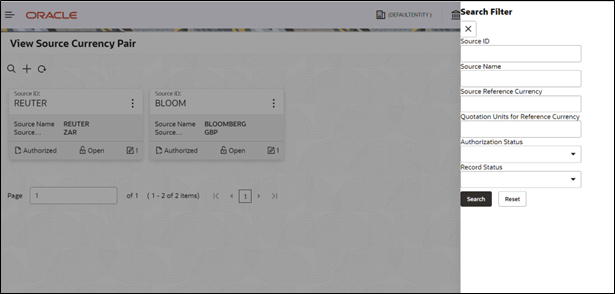

Retrieve View Source Currency Pair Records
- Edit Source Currency Pair Details
This topic provides the systematic instructions to edit Source Currency Pair record. - View Source Currency Pair Details
This topic provides the systematic instructions to view Source Currency Pair record. - Delete Source Currency Pair Detail
This topic provides the systematic instructions to delete Source Currency Pair record. - Authorize Source Currency Pair Detail
This topic provides the systematic instructions to authorize Source Currency Pair record. - Amend Source Currency Pair Details
This topic provides the systematic instructions to amend Source Currency Pair record. - Copy Attributes
This topic provides the systematic instructions to copy View Source Currency Pair record.
