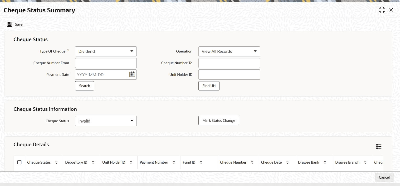

- In this screen, the details of the cheque you have selected are displayed in
View Mode.If you have selected an Operation to change the status of the cheque, the Cheque Status field is enabled, with the current status displayed, and you can select the required status by choosing from the options in the drop-down list.
- If the Operation you have selected is
View, then none of the details in the
Cheque Status screen can be changed, including the
Cheque Status.The latest status of the cheque is displayed.
- On Cheque Status Summary screen, specify the fields.For more information on fields, refer to the field description table.
Table 1-2 Cheque Status Summary - Field Description
Field Description Cheque Status This section displays the following cheque details. Type of Cheque Mandatory
Specify the type of cheque for which you wish to view details or change the status. The type can be any of the following:- Redemption
- Dividend
- Fee /Incentive
- Bonus
Operation Mandatory
Select the type of operation you wish to perform from the drop-down list. It includes:- View all records
- View Status Change Records
- Mark Status Change
Note: The field Cheque Status and the button Mark Status Change are enabled only if the type of Operation is Mark Status Change.
Cheque Number From Alphanumeric; 16 Characters; Optional
Enter the cheque number from which you wish to perform the operation specified.
Cheque Number To Alphanumeric; 16 Characters; Optional
Enter the Cheque number till which you require the operation you have specified.
Payment Date Date Format; Optional
Specify the payment date of the cheque(s).
Unit Holder ID Alphanumeric; 12 Characters; Optional
Specify the unit holder ID if you want view details/ make changes only for a specific unit holder.
Click the UH Find button to search for the specific unit holder.
Click OK after having specified all the relevant details. The system displays all the relevant details in the Cheque Status Details section.
Table Name Alphanumeric; 50 Characters; Mandatory
Specify the table name.
Cheque Status Information This section displays the following cheque details. Cheque Status Optional
The current status of the selected cheque is displayed here. It could be any of the following:- Lost: Indicates that information has been received from the unit holder that the cheque has been misplaced.
- Invalid: Indicates that the original cheque book that contained this issued cheque has been marked with the status Cancelled or Cheque Book Exhausted.
Click Mark Status Change button to apply the status change to the given cheque.
- On Cheque Details section of the Cheque
Status Summary screen, view the following details.The system displays the following cheque details:
- Cheque Status
- Depository ID
- Unit Holder ID
- Payment Number
- Fund ID
- Cheque Number
- Cheque Date
- Drawee Bank
- Drawee Branch
- Cheque Amount
- Transaction Number
