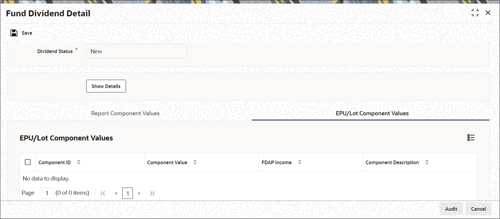

  1. Click EPU/Lot Component Values tab in the Fund Dividend Detail screen.
    The EPU/Lot Component Values are displayed.
    Figure 1-3 Fund Dividend Detail_EPU/Lot Component Values

    You can view the following EPU/Lot Component details:
    • Component ID
    • Component Value
    • FDAP Income
    • Component Description
