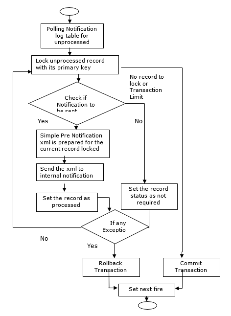

Scheduler Based Notification Flow
The Notification Process in FLEXCUBE can be done using the jobs scheduler as
follows:
- The trigger generated from Workbench will be inserting key details into a static notification log (STTB_NOTIFICATION).
- Once Job is triggered, a request is sent to the EJB layer from the job execution class and the notification log table will be polled for unprocessed records.
- Each unprocessed record is locked. The record is verified against the notification maintenance and checked whether notification is to be sent or not.
- If notification is to be sent, pre-notification message XML is built and it is sent to internal NOTIFY_QUEUE(JMS queue) configured in Gateway layer.
- The job is then rescheduled to fire next time based on the previous execution.
Figure 1-14 Flow Chart for Notification Flow in Scheduler

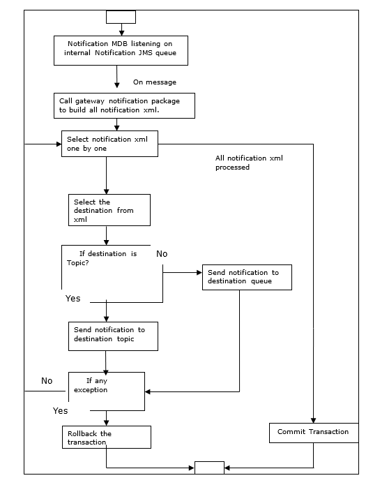

MDB Based Notification Flow
Notification processes in MDB are as follows:
- Notification MDB listens on the internal NOTIFY_QUEUE(JMS queue).
- On any message received, the MDB identifies which schema to connect using the JNDI name being present as part of the message XML.
- Gateway notification processing package is called from MDB to build notifications.
- In MDB, the notifications built are processed and sent to the destination specified in the corresponding notification.
- In case of an exception the transaction is rolled back.
- If all notifications are successfully processed, the transaction is committed.
Figure 1-15 Flow Chart for Notification Flow in MDB
