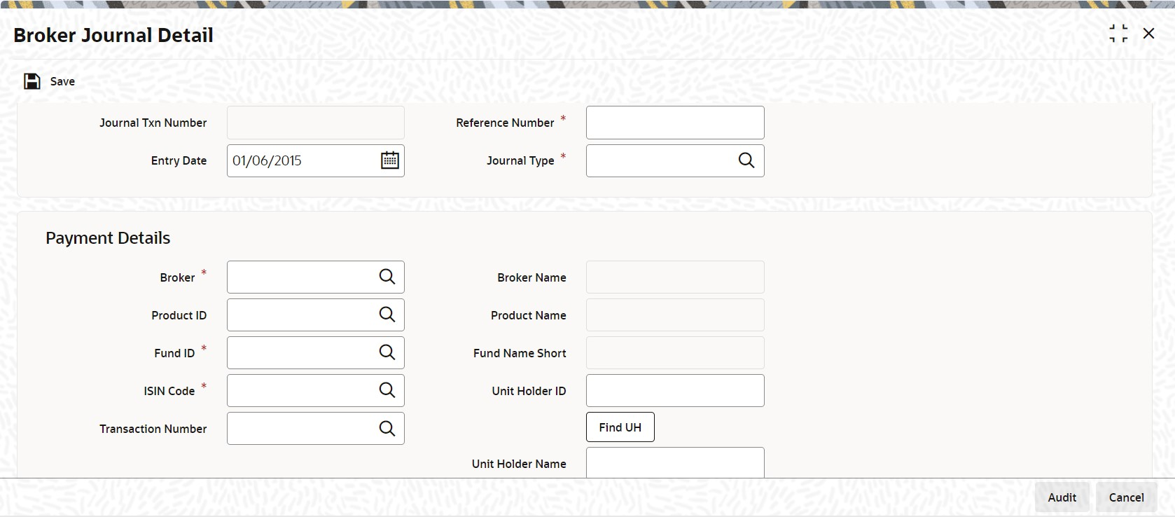

- On Home screen, type
UTDBRKJR
in the text box, and click Next.The Broker Journal Detail screen is displayed.
- In the screen, specify the following mandatory information for each accounting entry for a broker, for a transaction in a fund:
- The date of the entry, in the Entry Date field
- A unique reference number for the journal entry, in the Reference Number field.
- The currency for the journal entry, in the Journal Currency field.
- The payable or receivables resulting from the transaction, in the Payables and Receivables fields.
- Whether the entry is to be deemed an adjustment entry, as indicated in the Adjustment Entry field.
- Any applicable descriptive or narrative text qualifying the entry, in the Remarks field.
- The details of the mode of payment, in the Payment Details section.
- Click Save button to save your changes after you have
specified this data.You must have another user to authorize a journal entry for the same to be reflected in the database.
- On Broker Journal Detail screen, click
New to enter the details.For more information on fields, refer to the field description table.
