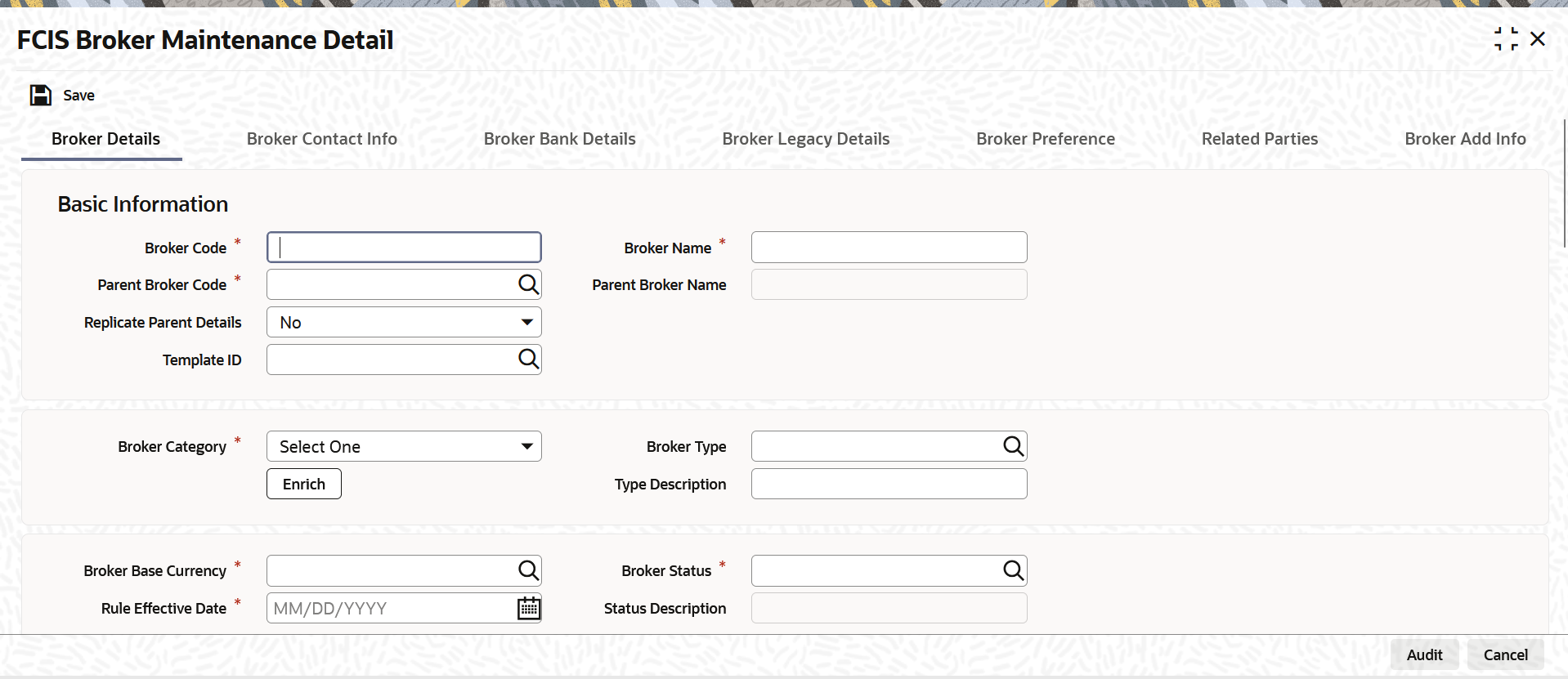

  1. On Home screen, type UTDBRKMN in the text box, and click Next.
    The FCIS Broker Maintenance Detail screen is displayed.
    Figure 4-3 FCIS Broker Maintenance Detail

  3. You can set up a broker in the system database by creating a record for the same in the FCIS Broker Maintenance Detail screen.
    • Specify all the mandatory information that is necessary to form a profile of the broker in the database.
    • Save your specifications.

  5. When you create a record for a broker in the FCIS Broker Maintenance Detail screen, you must specify the following data as mandatory information.
    1. A unique identifier for the broker record in the database, in the Broker Code field.
    2. The name of the broker, in the Broker Name field.
    3. The AMC in which the broker is designated to transact, in the AMC ID field.
    4. The system code of any broker that is designated as the immediate higher broker in the broker hierarchy, in the Parent Broker Code field. If the broker is to be designated as the highest in the hierarchy, then specify the code that you specified in the Broker Code field.
    5. If the broker is mapped to a broker type, indicate whether the frequency of commission payment defined for the selected broker type must also be deemed applicable to the broker. Indicate this in the Use Broker Type Payment Details field check box. If you select this check box the commission frequency of the broker type chosen will be defaulted for the broker.
    6. If the broker record has been amended, then indicate the Rule Effective Date from which the changes are effective in the system. Rule Effective Date cannot be back dated. Rule Effective Date can be Future Dated and system would make that rule effective only on that date during BOD.
    7. You are allowed to amend only the last available record for which Latest Rule is 1. If a transaction exists with that broker on that day, system will not allow you to save the broker details.
    8. If the status of the broker is to be disabled, indicate this by selecting the option WEEDED in the Broker Status field.
    9. If payment of commission is to be held back for any reason for the broker, indicate this by checking the Hold Back Payment field check box.
