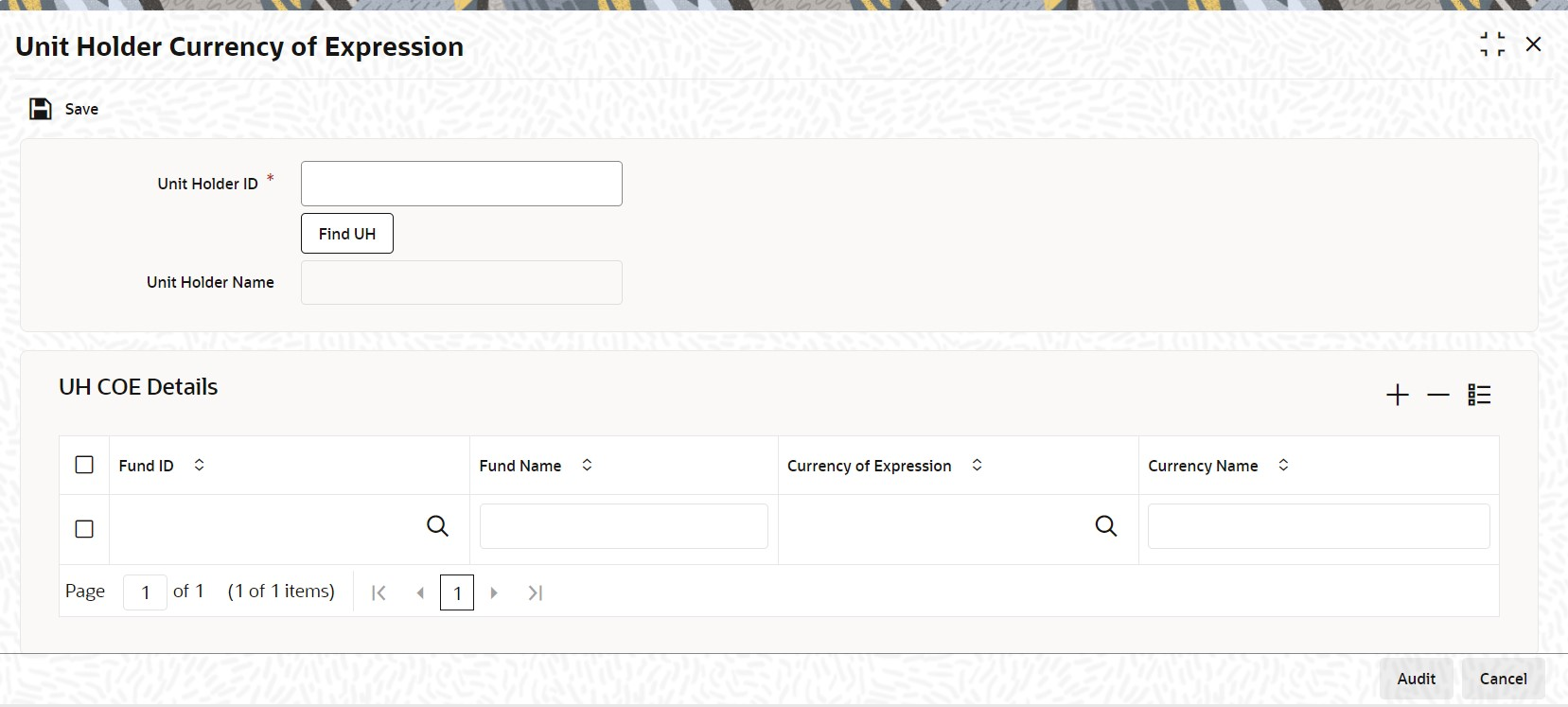

  1. On Home screen, type UTDUHCOE in the text box, and click Next.
    The Unit Holder Currency of Expression screen is displayed.
    Figure 2-37 Unit Holder Currency of Expression
  2. On Unit Holder Currency of Expression screen, specify the fields.
    Table 2-40 Unit Holder Currency of Expression - Field Description
