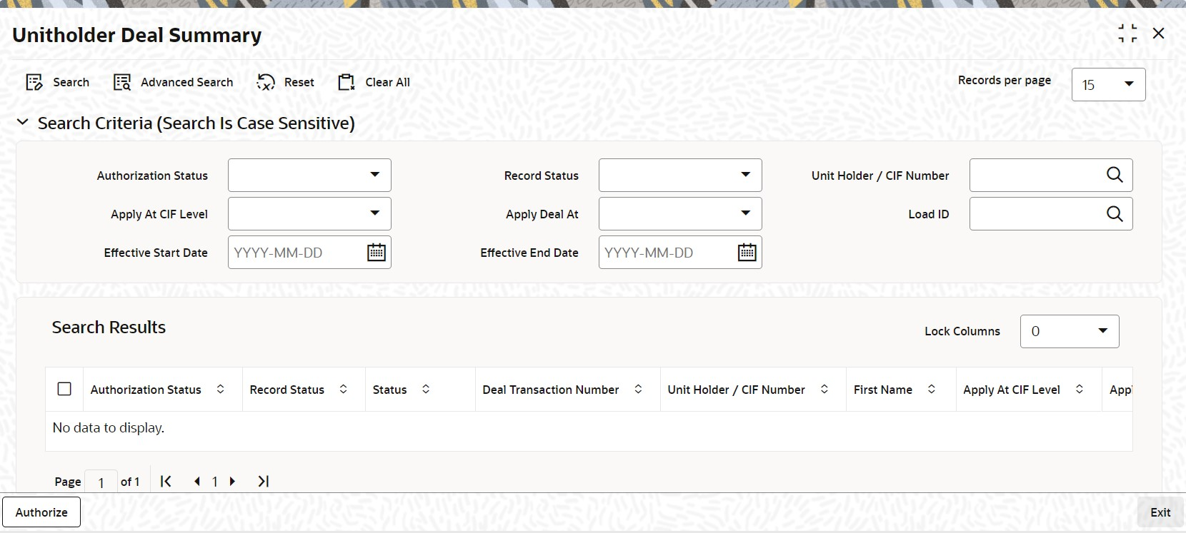

  1. On Home screen, type UTSUHDEL in the text box, and click Next.
    The Unitholder Deal Summary screen is displayed.
    Figure 3-7 Unitholder Deal Summary
  2. On Unitholder Deal Summary screen, specify any or all of the following details in the corresponding fields:
    • Authorization Status - If you choose the status, then the records matching the specified status are retrieved. If you do not choose any option, then all the records are retrieved.

  3. Click Search button to view the records.
    All the records with the specified details are retrieved and displayed in the screen.
