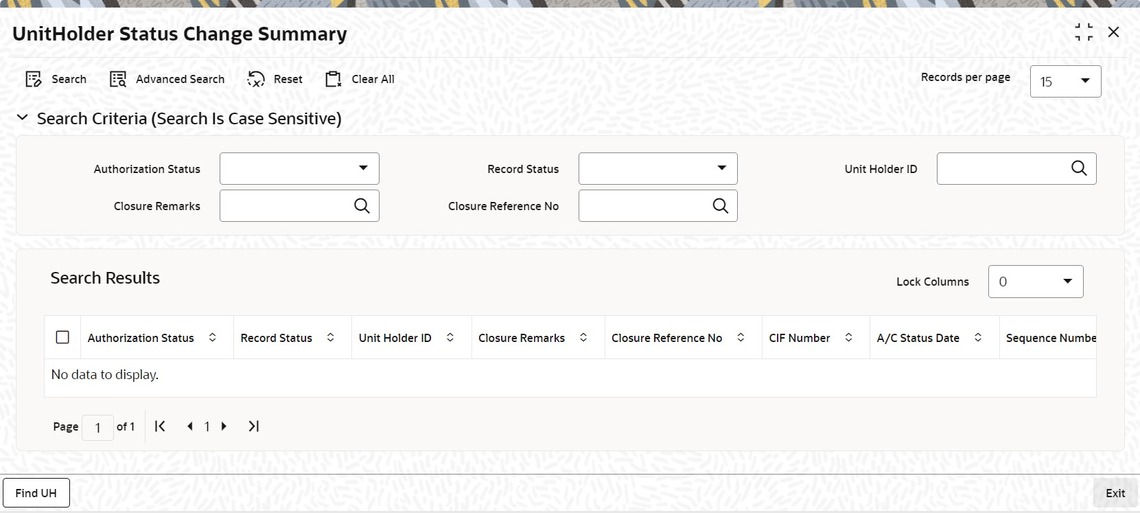

  1. On Home screen, type UTSACCLS in the text box, and click Next.
    The UnitHolder Status Change Summary screen is displayed.
    Figure 3-20 UnitHolder Status Change Summary
  2. On UnitHolder Status Change Summary screen, specify any or all of the following details in the corresponding fields:

  3. Click Search button to view the records.
    All the records with the specified details are retrieved and displayed in the screen.
