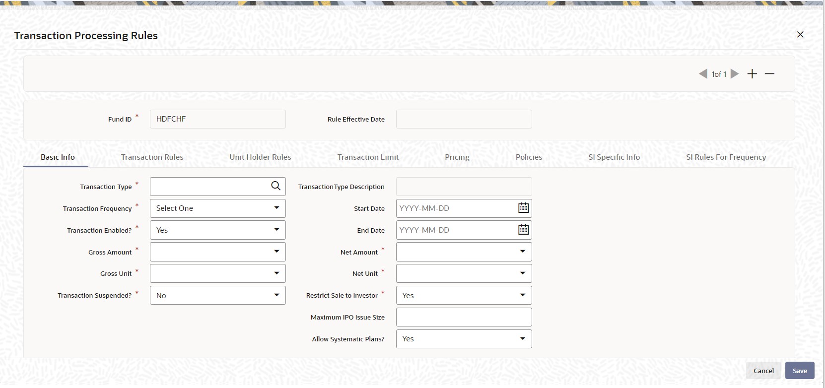

2.1.7.1 Basic Info
This topic provides information on basic info tab of transaction processing rules.
- Click Transaction Processing Rules, click Basic Info tab in screen to specify the details.The Basic Information screen is displayed.
- On Basic Info tab, specify the fields. For information on fields in the screen, refer the below table.
Table 2-28 Transaction Processing Rules - Basic Info
