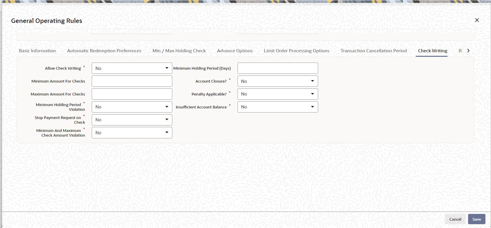

| Allow Check Writing |
Mandatory You can use
this field to indicate whether cheque writing facility
is allowed for investors who invest in this fund. Select
Yes from drop-down list to indicate that
cheque writing is allowed.
| Minimum Amount for Checks |
Numeric; 18 Characters; Optional - If
cheque writing is allowed for the fund, then this
information is mandatory. Specify the
minimum amount that can be redeemed through a redemption
cheque, for investors holding balances in the fund, who
have opted for cheque writing facility. If the amount
written on a cheque falls below this value, the cheque
attracts penal charges.
| Maximum Amount for Checks |
Numeric, 18 Characters; Optional - If
maximum amount that can be redeemed through a redemption
written on a cheque exceeds this value, the cheque
| Minimum Holding Period
Violation |
this field to indicate whether a violation of the
holding period for balances in this fund, by a unit
holder using the cheque writing facility must be
validated for. Select ‘Yes’ from drop-down list to
indicate validating of violation of the holding
period.
| Stop Payment Request on Check |
this field to indicate whether a stop payment request
can be applied on a cheque issued by a unit holder
availing cheque writing facility, for this fund. Select
Yes from dropdown list to indicate that a
stop payment can be applied.
| Minimum and Maximum Check Amount
Violation |
Numeric; 6 Characters; Mandatory You can use this field to indicate whether
a violation of the minimum and maximum cheque amounts by
a unit holder using the cheque writing facility in this
fund, must be validated for. Select Yes from
drop-down list to indicate validating of violation of
the maximum and minimum cheque amounts.
| Minimum Holding Period (Days) |
Numeric; 5 Characters; Optional - If
check writing is allowed for the fund, then this
minimum number of days for which units must be held in
the investor account before they can be redeemed through
a redemption cheque.
| Account Closure |
this field to indicate whether an investor can close the
unit holder account through cheque redemption.
SelectYes from drop-down list to indicate
that account closure through cheque writing is allowed.
| Penalty Applicable |
unit holder account through a cheque redemption. Select
allowed.
| Insufficient Account Balance |
this field to indicate whether insufficient balance in
this fund, in the account of a unit holder using the
cheque writing facility must be validated for. Select
validating of insufficient balance
situations.
