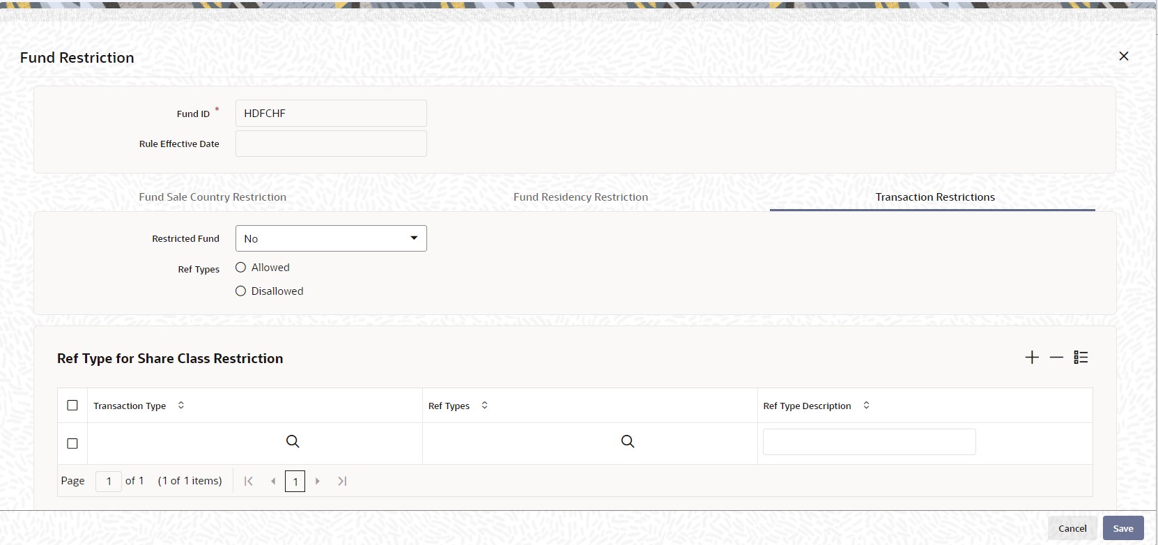

2.1.8.3 Inflow Restriction
This topic provides on inflow restriction tab of fund restriction screen.
  1. Click Fund Restriction, click Inflow Restriction tab in screen to specify the details.
    The Inflow Restriction screen is displayed.
    Figure 2-26 Fund Restriction - Transaction Restriction
  2. On Inflow Restriction tab, specify the details.
    For more information on fields in the screen, refer the below table.
