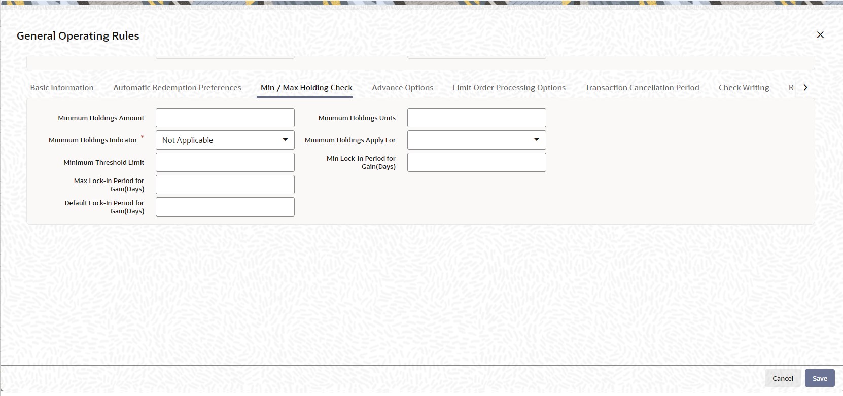

2.1.6.3 Min or Max Holding Check
This topic provides information on min/max holding check tab details.
You can indicate the minimum/maximum holdings balance that is required for redemption, switch or transfer transaction, for a CIF or an individual unit holder, in the fund. The minimum holdings value can be specified either as an amount, number of units, or redeemable value of units.
  1. Click on Min/Max Holding Check tab in General Operating Rules screen to specify the details.
    The The Min/Max Holding Check details are displayed in General Operating Rules screen.
    Figure 2-8 Min/Max Holding Check
    As part of the minimum holdings options, you can also indicate whether the holdings considered for validation are those of all unit holders under a CIF, or for an individual unit holder.
    The above check is not validated online during transaction capture or authorization. When there are transactions into a fund violating the minimum holdings validation, the system logs an exception in the Pre-End of Day Check screen. During the End of Day processes, the system allocates the transactions, logging the exceptions in respect of them.
    For more information on fields in the screen, refer the below table.
