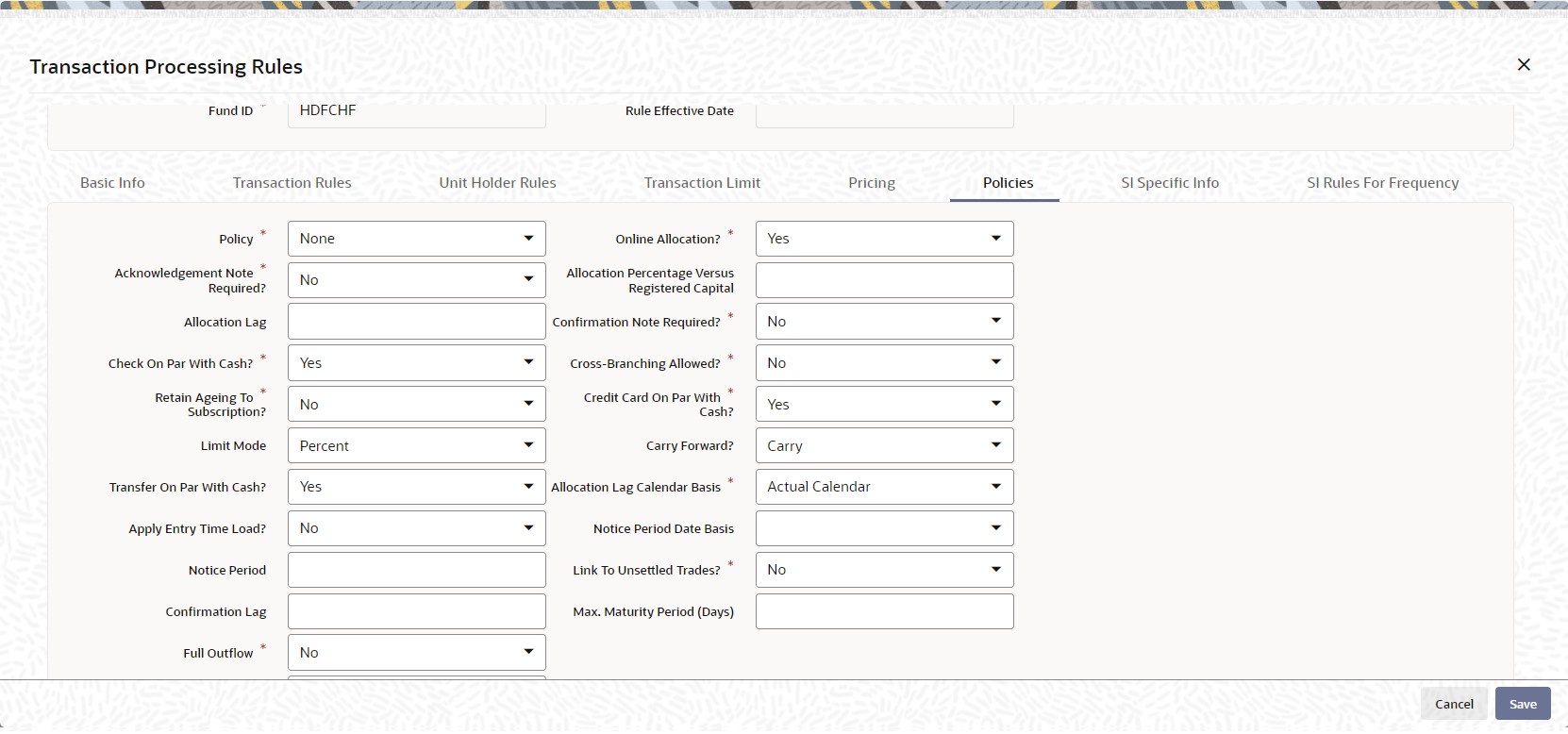

2.1.7.6 Policies
This topic provides information on policies tab of transaction processing rules screen.
In this section, you can set up the following information:
  • Allocation details such as allowing of online allocation, credit card/check allocation on par with cash, allocation and confirmation lags, and the allocation policies.
  • The limit redemption mode, which can be either percentage of holdings, amount or units.
  1. Click Transaction Processing Rules, click Policies tab in screen to specify the details.
    The Policies screen is displayed.
  2. On Policies tab, specify the details.
    For more information on fields in the screen, refer the below table.
    Table 2-34 Transaction Processing Rules - Policies
    Field Description
    Policy Mandatory
    Select First In First Out or Proportionate option from drop-down list to specify the policy for allocation in case the maximum limit is reached for a given day. This policy is with respect to the allocation percentage that is allowed against the fund corpus.
