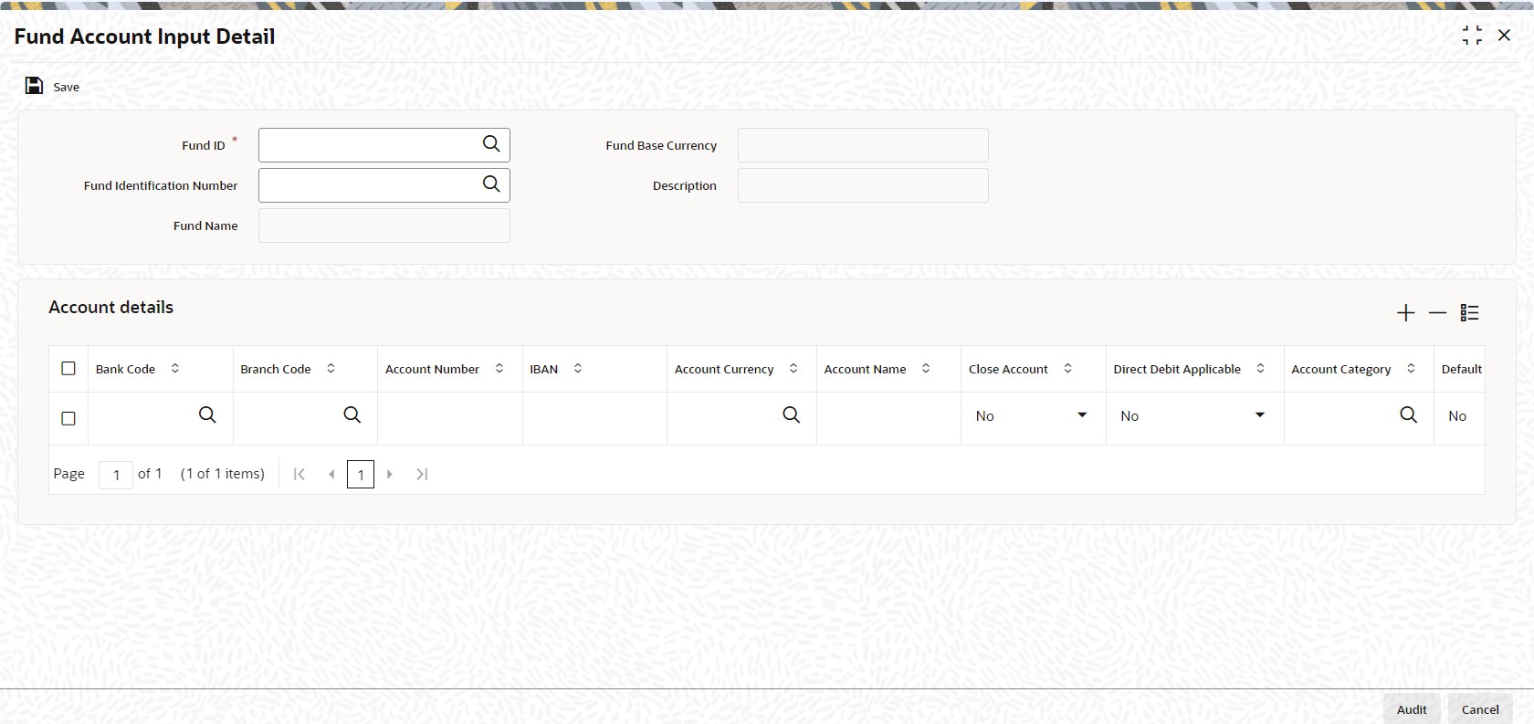

  1. On Home screen, type UTDFNDAC in the text box and click Next.
    The Fund Account Input Detail screen is displayed.
    Figure 3-34 Fund Account Input Detail
  2. Click New to enter the details of the new fund account you wish to maintain.
  3. On Fund Account Input Detail screen, specify the fields.
