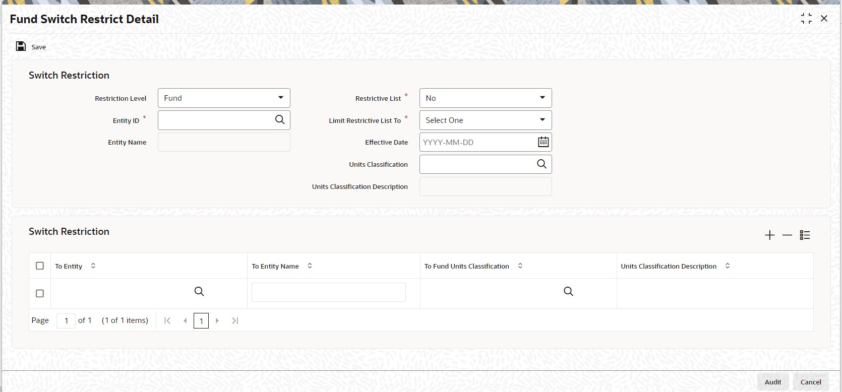

You can maintain such restrictive or positive lists for a fund in the Fund Switch Restrict Detail screen.
- On Home screen, type UTDFNSWR in the text box and click Next.
- Select New from the Actions menu in the Application tool bar or click
New icon to enter the details of the lists on switch
transactions.The Fund Switch Restrict Detail screen is displayed.

Table 3-3 Fund Switch Restrict Detail - Switch Restriction
Field Description Restriction Level Optional Select the Restriction Level from the drop-down list. The list displays the following values:
- Fund
- Fund Family
- Legal Entity
- Fund Type
Entity ID Alphanumeric; 12 Characters; Mandatory Specify the Entity ID. Alternatively, you can select the Entity ID form the option list. The list displays all valid entity ID maintained in the system.
Entity Name Display The system displays the entity name for the selected Entity ID.
Restrictive List Mandatory For a fund, you might require to disallow switch transactions into a few selected funds (a restrictive list); or, you might require maintaining a list of funds into which switch transactions are allowed (a positive list)
You can indicate that you are maintaining a restrictive list, by choosing Yes from the drop down list. To indicate that the list is a positive list, choose No from the drop-down list.
If you indicate a restrictive list, switch transactions into any of the selected funds in the list will not be allowed. If you indicate a positive list, switch transactions are allowed only into any of the selected funds in the list. For a fund, only a restrictive list OR a positive list can be maintained, not both.
Limit Restrictive List To Mandatory If you have indicated a restrictive list, you can indicate the range of funds for which the restrictive list applies from the drop-down list. The list displays the following values:
- No Restriction
- Fund Family
- AMC
- Legal Entity
- Units Classification
Indicating the range of funds in this field is dependant on the switching logic applicable for the AMC (also in the case of Distributors), as given below:
- If the restrictions are being
maintained for a Distributor, and no restrictions
have been indicated for switch transactions, you can
indicate whether the restricted list would be
applicable for switch transactions involving:
- All funds (select No Restrictions in this field)
- Funds within the same AMC
- Funds within the same fund family
- Legal Entity
- If the switching logic for the AMC is Switch Within Funds of AMC, the Within AMC option is selected in this field and cannot be changed. The restrictive list will only be applicable for funds within the AMC.
- If the switching logic for the AMC is Switch Within Funds of Fund Family, the Within Fund Family option is selected in this field and cannot be changed. The restrictive list will only be applicable for funds within the same fund family.
This field is not applicable for positive lists; the switching logic of the AMC is defaulted here and cannot be changed.
Units Classification Alphanumeric; 1 Character; Optional Specify the Units Classification details. Alternatively, you can select Units Classification code from the option list. The list displays all valid unit classification code maintained in the system.
Units Classification Description Alphanumeric; 60 Characters; Optional Specify the Units Classification Description.
To Entity Alphanumeric; 12 Characters; Mandatory Select the To Entity ID into which switch transactions from the selected From Fund are disallowed (if you are maintaining a restrictive list) or allowed (if you are maintaining a positive list). When the restrictive / positive list is applied, the fund you select here is considered the To Fund.
To select the Fund, you can either indicate the Fund ID or the ISIN Code of the fund. When you select the Fund, the short name of the fund is also displayed.
The funds available for selection in this field depend on the option selected in the Limit Restricted Funds To field:
- If the No Restriction option has been chosen, all valid funds in the system are available for selection in this field.
- If Within AMC has been chosen, all funds belonging to the AMC of the from fund are available for selection
- If Within Fund Family has been chosen, all funds belonging to the fund family of the ‘from fund’ are available for selection
To Entity Name Display The system displays the To Entity Name for the selected To Entity ID.
To Fund Units Classification Alphanumeric; 1 Character; Optional Specify the To Funds Units Classification details. Alternatively, you can select To Funds Units Classification from the option list. The list displays all valid To fund units classification code maintained in the system.
