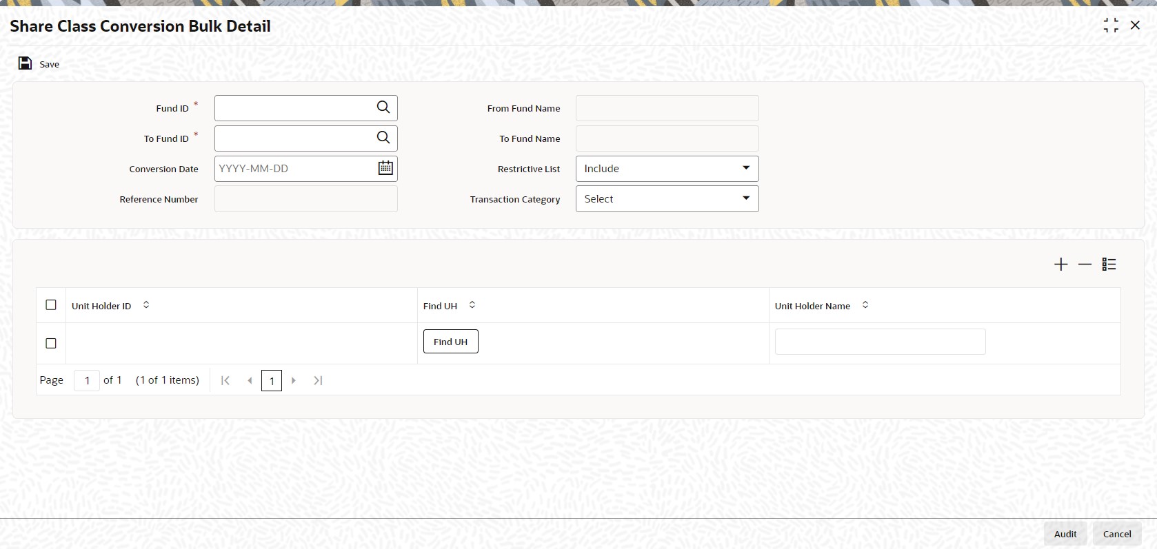

You can maintain Share Class Bulk Conversion details using Share Class Conversion - Bulk screen.
- On Home screen, type UTDSCBLK
in the text box and click
Next.The Share Class Conversion Bulk Detail screen is displayed.
Figure 1-14 Share Class Conversion Bulk Detail
- Select New from the Actions menu in the Application tool bar or click New icon to enter the details of the Mapping.
- On Share Class Conversion Bulk Detail screen, specify
the fields.For more information on fields in the screen, refer the below table.

Field Description From Fund ID Alphanumeric; 6 Characters; Mandatory Specify the From Fund ID. You can also select the From Fund ID from the adjoining option list.
From Fund Name Display The system displays the From Fund Name details for the selected From Fund ID.
To Fund ID Alphanumeric; 6 Characters; Mandatory Specify the To Fund ID. You can also select the To Fund ID from the adjoining option list.
During transaction, if any To fund is not maintained at the fund level of From Fund then the system will display the following error message as To Fund is not specified for conversion.
Note: In GTA setup and in Normal switch with reftype SB Case.- In AGY without cross branching, fields funfd ID and To und ID can have funds selected within same segment.
- In AGY with cross branching, fields fund ID and To fund ID can have funds select\u0002ed across segments.
To Fund Name Display The system displays the To Fund Name for the selected To Fund ID.
Conversion Date Date Format; Mandatory Specify the Conversion Date.
Reference Number Display The system displays the conversion reference number.
Restrictive List Optional Select the appropriate value from the drop down list to include or exclude the list of unit holders for conversion:
- Include
- Exclude
Transaction Category Optional Select the transaction category from the following list of drop down values:
- Advised Business
- Execution Only
- Legacy
Table 1-10 Share Class Conversion - Bulk Detail - Share Class Conversion
Field Description Unit Holder ID Alphanumeric; 12 Characters; Optional Specify the Unit Holder ID. You can query for unit holder ID by clicking Find UH button.
Unit Holder Name Display The system displays the unit holder name.
