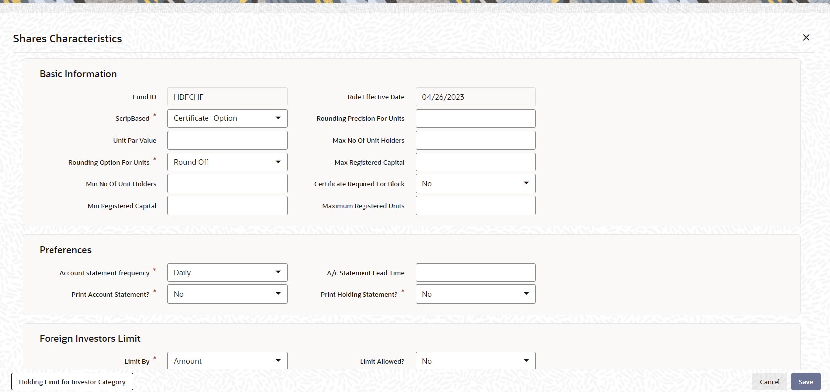

To set up the Shares Characteristics rule for a fund, use the Shares Characteristics screen.
- Click Shares Characteristics tab from the
Fund Rules Detail screen.The Shares Characteristics screen is displayed.
Before you set up a Shares Characteristics profile record for a fund, it is desirable to ensure that the fund already has an existing, unauthorized Fund Rules profile record.
- On Shares Characteristics screen, specify the
fields.For more information on fields in the screen, refer the below table.
Table 2-4 Shares Characteristics
Field Description Fund ID Display This field indicates the ID fund for which you are setting up the Shares Characteristics profile. This information is defaulted from the Fund Demographics screen.
