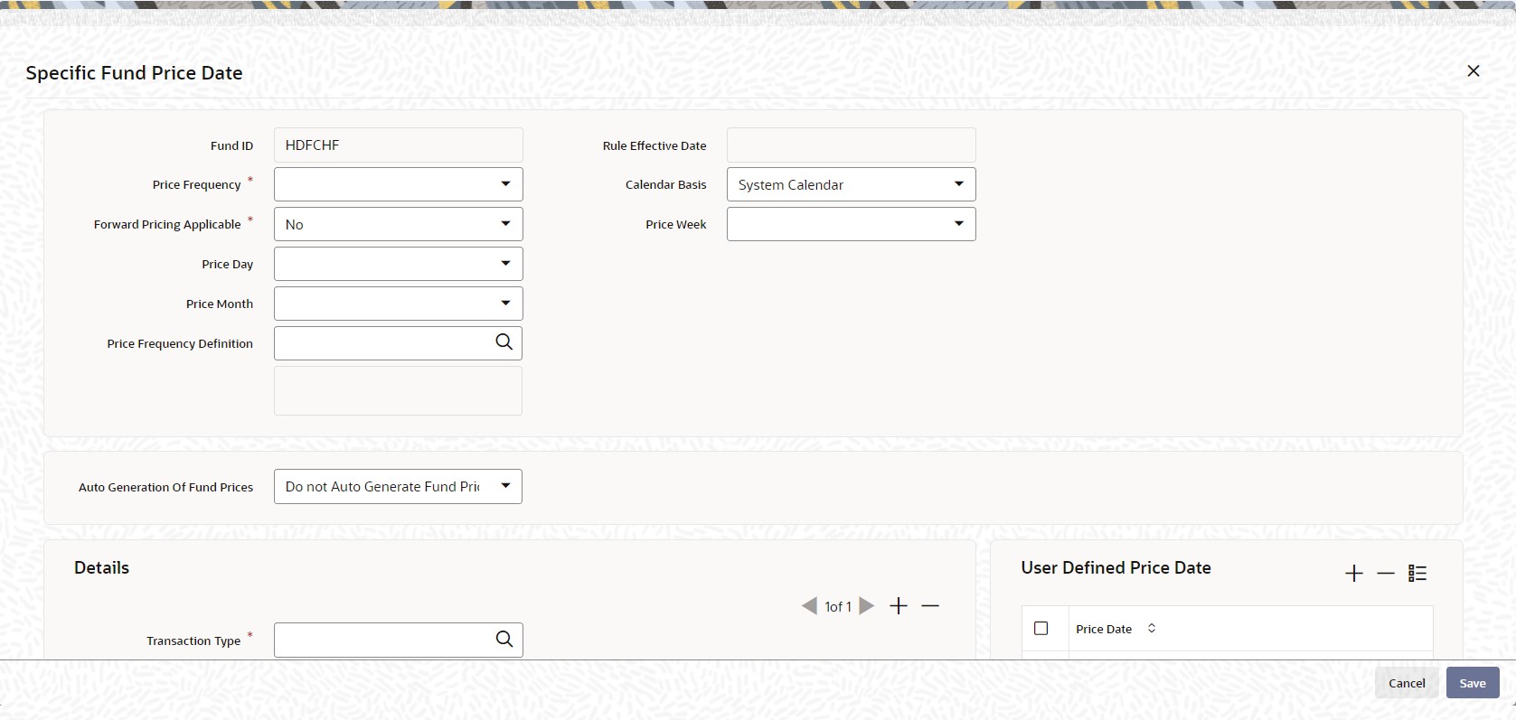

- Click Specific Fund Price Date button from the Fund Rules Detail screenThe Specific Fund Price Date screen is displayed.

- On Specific Fund Price Date screen, specify the fields.For more information on fields in the screen, refer the below table.
Table 2-56 Specific Fund Price Date
Field Description Fund ID Display This field indicates the ID fund for which you are setting up the Specific Price Date rule. This information is defaulted from the Fund Demographics screen.
