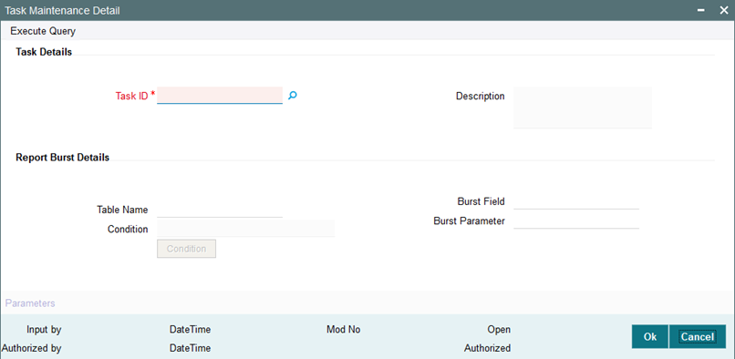

User has to maintain TASKID parameter to specify the Report Parameters. UTDTASK is the screen to maintain Report Parameters.
Figure 3-2 Task Maintenance Detail

    If the job is configured as stateless, the value of field Max Number Instances will denote the number of threads that can be executed in parallel. If the job is configured as stateful, then the above value will denote the number of missed instances that will be queued up so that Quartz Scheduler would start executing them once a long running job ends. This field specifies the number of such job instances that needs to be queued up.
    The class defined in the class field has to be provided a fully qualified name.
    Job params can be added to a particular java job in Task Maintenance Detail screen.
