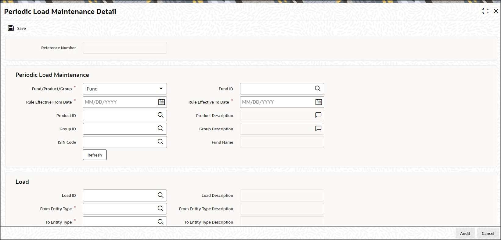

- On Home screen, type UTDPERLM in the text box, and click Next.The Periodic Load Maintenance Detail screen is displayed.
Figure 6-1 Periodic Load Maintenance Detail
- On Periodic Load Maintenance Detail screen, click New to enter the details.For more information on fields, refer to the field description table.
