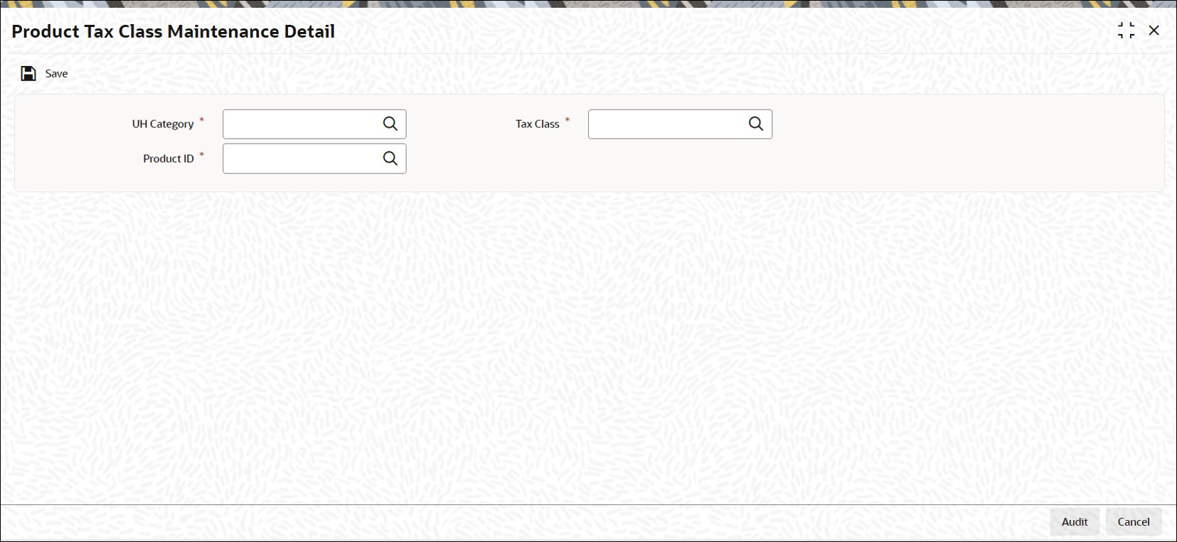

  1. On Home screen, type LEDPRTAX in the text box, and click Next.
    You can create four different funds for each Fund Tax Class under one Fund Group.
    The Product Tax Class Maintenance Detail screen is displayed.
    Figure 2-7 Product Tax Class Maintenance Detail
  2. On Product Tax Class Maintenance Detail screen, click New to enter the details.
    Table 2-4 Product Tax Class Maintenance Detail - Field Description
    Field Description
    UH Category
    Alphanumeric; 2 Characters; Mandatory
    Specify the Unit Holder category details. Alternatively, you can select the UH Category from the option list. The list displays all valid UH Category details maintained in the system.
    Product ID
    Alphanumeric; 10 Characters; Mandatory
    Specify the product ID. Alternatively, you can select the Product ID from the option list. The list displays all valid Product ID maintained in the system.
    Tax Class
    Alphanumeric; 3 Characters; Mandatory
    Specify tax class details. Alternatively, you can select tax class details from the option list. The list displays all valid Tax Class details maintained in the system.
    Sub Type
    Specify the sub type code after entering the transaction type, for which the Sub type transaction is processed.
