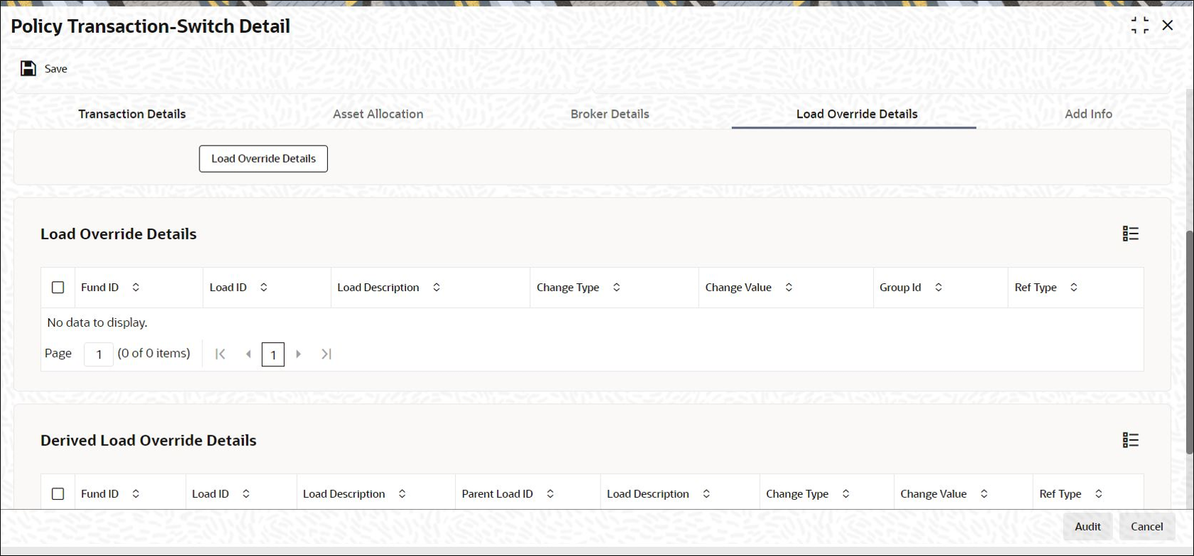

4.1.6 Load Override Details Tab
This topic explains the load override details tab of Policy Transaction-Switch Detail screen.
You can override or alter the value of load mapped to the selected fund.
  1. On Policy Transaction-Switch Detail screen, click Load Override Details tab.
    The Load Override Details are displayed.
    Figure 4-7 Policy Transaction-Switch Detail_Load Override Details Tab
  2. You can override or alter the value of load mapped to the selected fund. You can do so in the Load Override Details screen which is invoked when you click on the Load Override Details Link. The following details are displayed:
    1. If you click the Load Override Details button, the system defaults the load details.
    2. If you do not click this button, then the system will not default even if the fund has load. In this case, load will get computed during allocation only.
  3. On Load Override Details tab, specify the fields.
