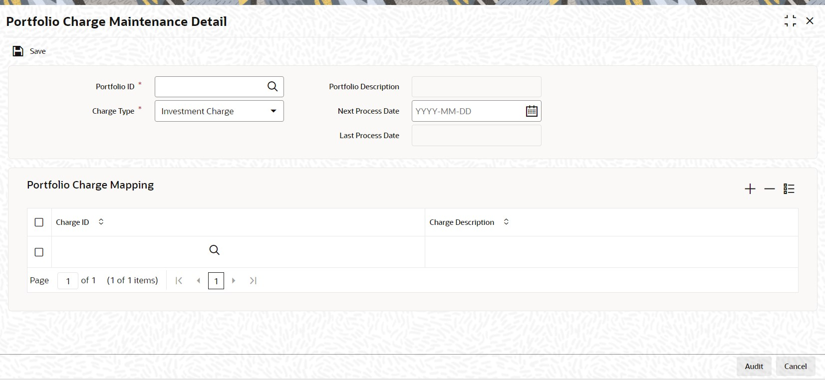

  1. On Home screen, type PADCHMAP in the text box, and click Next.
    The Portfolio Charge Maintenance Detail screen is displayed.
    Figure 1-44 Portfolio Charge Maintenance Detail
  2. On Portfolio Charge Maintenance Detail screen, click New to enter the details.
    Table 1-37 Portfolio Charge Maintenance Detail - Field Description
    Field Description
    Portfolio ID Alphanumeric; 12 Characters; Mandatory
    Specify portfolio ID. Alternatively, you can select portfolio ID from option list. The list displays all valid portfolio ID maintained in the system.
    Portfolio Description Display
    The system displays the description for the selected portfolio ID.
    Charge Type Mandatory
    Select the type of charge from the drop-down list. The list displays the following values:
    • Investment Charge
    • Annual Maintenance Charge
    Investment charge is applicable only for investment orders captured from Pension platform.
    Annual Maintenance charge is the charge incurred on latest portfolio balance of the party and will be computed on annual basis. The system will generate a withdrawal order for the charge amount.
    Note: Investment charges are not applicable for Adjustment investment orders and Rebalance adjustment investment orders.
    Next Process Date Date Format; Optional
    Select next process date from the adjoining calendar.
    You can specify Next process date only if the charge type is Annual Maintenance Charge.
    You can update Next process date until first authorization. Post first time authorization, you can update next process date during EOD Batch only.
    Note: Next Process Date is amendable only till the first processing.
    Last Process Date Display
    The system displays the last process date based on the Next process date.
    Both Next Process Date and Last Process Date field is not applicable for Investment Charge type. The system will display an error message if the next process date is maintained for investment charge.
    Table 1-38 Portfolio Charge Mapping - Field Description
    Field Description
    Charge ID Alphanumeric; 10 Characters; Mandatory
    Specify the charge ID. Alternatively, you can select charge ID from the option list. The list displays charge ID maintained in the system.
    Charge Description Display
    The system displays the description for the selected charge ID.
    Note: The system will use the latest available charge that is authorised once for computation.
