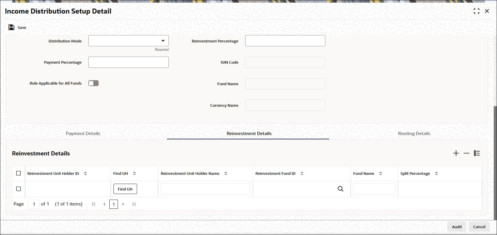

This topic explains the reinvestment details tab of Income Distribution Setup Detail.
- On Income Distribution Setup Detail screen, click Reinvestment Details tab to capture the details.The Reinvestment Details are displayed.
Figure 2-21 Income Distribution Setup Detail_Reinvestment Details Tab
- you can define the pattern in which the entity can reinvest income earnings back into the funds of the AMC.

- On Reinvestment Details Tab, specify the fields.For more information on fields, refer to the field description table.
