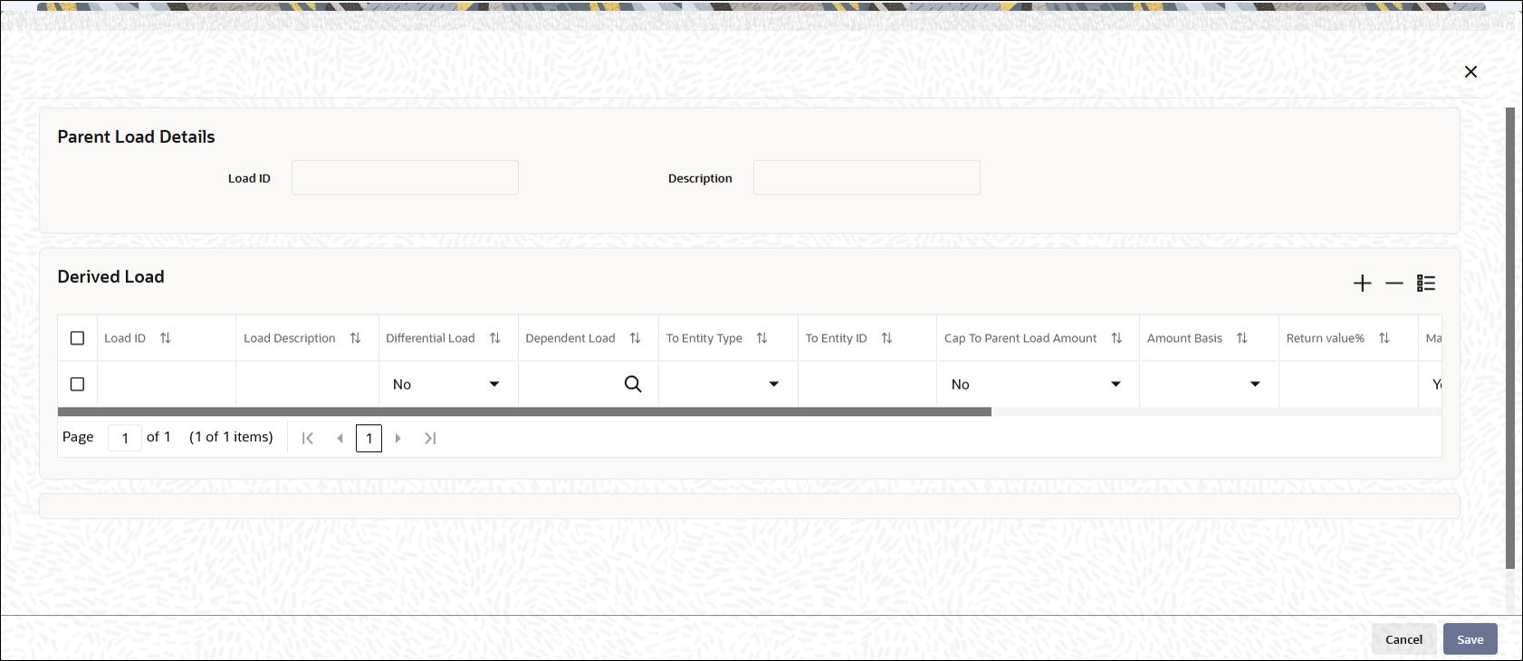

- Create a derived load that is dependent on the main load after you have created a load in the Load Definition screen.
- Click Derived button.The Derived Load Set Up screen is displayed.
Figure 7-5 Load Maintenance Detail_Derived Button
- On Derived Load Set Up screen, specify the fields.For more information on fields, refer to the field description table.
Table 7-7 Derived Load Set Up - Field Description
Field Description Load ID Display Only The ID of the Load to which the derived load that is being set up should be mapped, is displayed here, from the Load Definition screen. This is the parent load.
Description Display The system displays the description of the load ID.
Derived Load Section In this section, you may specify the parameters for a new derived load. Once you tab out of the last field in the row, (i.e. the Criteria field), the record is saved automatically.
Load ID Numeric; 5 Characters; Mandatory Specify a unique alphanumeric identifier for the derived load. This ID must not be the ID of a load already existing in the system database.
Load Description Alphanumeric; 60 Characters; Mandatory Enter some descriptive or narrative text, qualifying the derived load. It should describe the purpose for which the load has been set.
Differential Load Optional Select the differential load status from the drop-down list. The list displays the following values:- Yes
- No
Dependent Load Alphanumeric; 6 Characters; Mandatory Specify the dependent load.
To Entity Type Optional Select the type of entity that will be the recipient of the derived load from the drop-down list.
The load setup must be applicable for the entity type you select in this field. The list displays the following values:- Agent
- Broker
- Bulk Client
- Distributor
- Fund
- Bank Branch
- Bank
- Clearing Agent
- AMC
- Agency Branch
- Policy
- Check Vendor
- Registrar
- Custodian
- Trustee
- Investor
- Accounting and Valuation Agent
- Underwriter
- Transaction
- Fund Price
To Entity ID Alphanumeric; 12 Characters; Optional Specify the ID of the entity to which this load is payable. This must be the ID of a valid entity in the system, and the load setup must be applicable for this entity type.
Cap to Parent Load Amount Optional Select
Yesto indicate that the derived load amount is to be capped to the parent load amount. If selected asYesthen the sum of derived load amounts cannot be greater than the parent load amount. If not, the net derived amount can be negative (that is, the resultant front end load for a particular entity could be negative).This specification is used for derived loads that are set up for the purpose of fee/commission sharing between the AMC and the Distributors.
Amount Basis Optional In this field, you can indicate whether the derived load is a percentage of the parent load amount, or whether it is derived based on the transaction amount.
Select either Gross or Net to indicate that the derived load is to be derived based on the transaction amount; leave this field blank to indicate that the derived load is a percentage of the parent load amount.
This specification is used for derived loads that are set up for the purpose of fee/ commission sharing between the AMC and the Distributors.
Return Percentage Numeric; 22 Characters; Optional Enter the load percentage that is applicable for this derived load. This value must be greater than zero and less than one hundred.
Mandatory Optional Select
Yesto indicate that the derived load is to be processed as a mandatory load. If you selectNothen the derived load is deemed to be an optional load.A mandatory derived load will be applied (or processed) based on the criteria setup for this load.
An optional derived load will be applied based on the priority you assign to it, depending upon the priority number you specify in the Priority No. field in this screen.
Priority No. Numeric; 22 Characters; Optional Specify the priority number that will indicate the priority of application for the derived load.
- Click Criteria link to specify the criteria.The Query Builder is opened and you can specify an SQL statement, by the directives of which the load will be processed.
- Click Criteria button to invoke Criteria screen.
