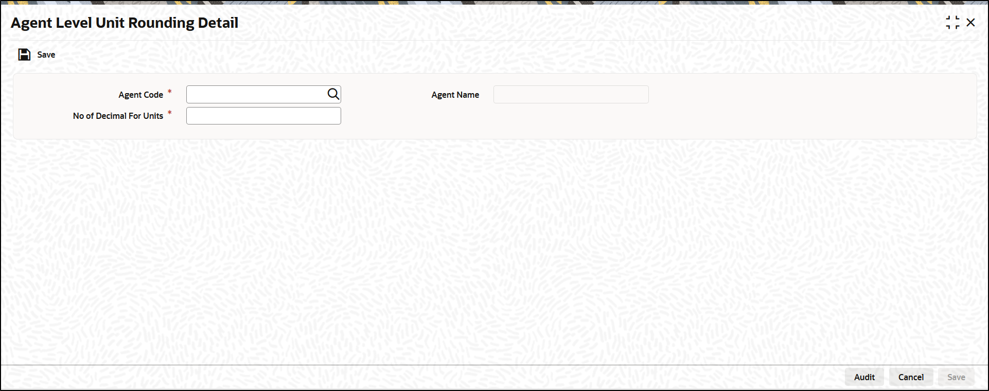

2.15 Process Agent Level Unit Rounding Detail
This topic provides the systematic instructions to capture rounding precision for units at agent level.
Design scope
Along with the existing Rounding Precision at fund level, Rounding Precision at agent level has been also considered during units rounding process.
- If the Agent level rounding is not maintained, then the fund level precisions will be considered.
- If the Agent level precisions are higher than the fund level, then the later will be considered.
Features in scope
Below features are impacted in Agent Level Rounding enhancement:
- No. of Decimals for Units which is maintained for the Intermediary Agent, has to be considered during allocation along with the existing round off or truncate flag at the fund level.
- If TXNBROKERS is turned ON, then the No. of Decimals for Units is not applicable.
- Lien marking/Unmarking (Block/Unblock) transactions are not in the scope of Agent Level Rounding. Fund Level rounding is continued for such Block/Unblock transactions.
- The latest available precision maintained for the agent has to be considered during allocation. Subsequent maintenance/amendment will not impact the allotted units.
- Rounding precision for units is applicable only for below mentioned Transactions.
- IPO
- Subscription
- Redemption
- Switch Transfer
