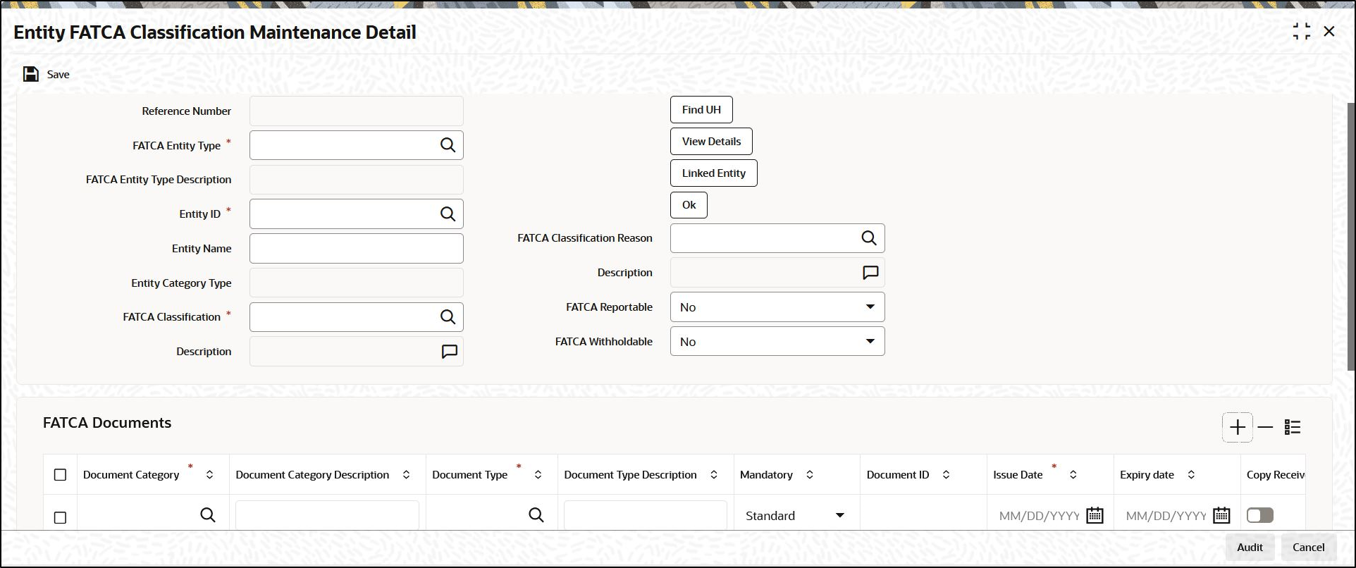

6.2 Process Entity FATCA Classification Maintenance Detail
This topic provides the systematic instructions to maintain FATCA Classification and record document details.
- On Home screen, type
UTDFATMT
in the text box, and click Next.The Entity FATCA Classification Maintenance Detail screen is displayed.
Figure 6-1 Entity FATCA Classification Maintenance Detail
- On Entity FATCA Classification Maintenance Detail
screen, click New to enter the details.For more information on fields, refer to the field description table.
Table 6-2 Entity FATCA Classification Maintenance Detail - Field Description
Field Description Reference Number Display The system displays the reference number.
FATCA Entity Type Alphanumeric; 2 Characters; Mandatory Select the FATCA entity type from the adjoining option list. The options available are:- Unit Holder
- Broker
- Single Entity
- Nominee
FATCA Entity Type Description Display The system displays the description for the selected FATCA entity type.
Entity ID Alphanumeric; 12 Characters; Mandatory Select the Entity identification from the adjoining option list.
You can also query for entity ID by clicking Find UH button.
Entity Name Display The system defaults the entity name from the entity record.
Entity Category Type Display The system displays the entity category type.
FATCA Classification Alphanumeric; 25 Characters; Mandatory Select the FATCA Classification from the adjoining option list.
Description Display The system displays the description for the selected FATCA classification.
FATCA Classification Reason Alphanumeric; 25 Characters; Mandatory Select the reason for FATCA classification from the adjoining option list.
Description Display The system displays the description for the selected FATCA classification reason.
FATCA Reportable Optional Select the FATCA Reportable status for the entity selected from the drop-down list. The list displays the following values:- Yes
- No
FATCA With holdable Optional Select the FATCA with holdable status for the entity selected from the drop-down list. The list displays the following values:- Yes
- No
FATCA Documents The section displays the following fields.
Document Category Alphanumeric; 25 Characters; Mandatory Select the document category from the adjoining option list.
Document Category Description Display The system displays the description for the selected document category.
Document Type Alphanumeric; 25 Characters; Mandatory Select the type of the document from the adjoining option list.
Document Type Description Display The system displays the description for the selected document type.
Mandatory Optional You need to indicate whether the document is mandatory or optional. The drop-down list displays the following options:- Standard - This indicates that the document is mandatory
- Additional - This indicates that the document is optional
Select the appropriate option.
Document ID Alphanumeric; 25 Characters; Optional Specify the document identification.
Issue Date Date Format; Mandatory Specify the issue date of the received document.
Expiry Date Date Format; Optional Specify the expiry date of the received document.
Copy Received Mandatory Check this box to indicate that the copy is received.
Original Received Mandatory Check this box to indicate that the original is received.
Received Date Date Format; Optional Specify the document received date.
Document Reference Number Alphanumeric; Optional Specify the document tracking reference number.
Remarks Alphanumeric; 255 Characters; Optional Specify remarks, if any.
Chasing Date Date Format; Optional Specify the document chasing date.
Document Reference Number Alphanumeric; 255 Characters; Optional Specify the document reference number
Document Serial Number Display The system displays the document serial number.
Document Upload Click this button to upload or view the documents.
FATCA Status The section displays the following fields.
FATCA Compliant Display The system displays whether you are FATCA compliant.
Description Display The system displays the description for the FATCA compliant.
Reason Alphanumeric; 255 Characters; Optional Specify remarks, if any.

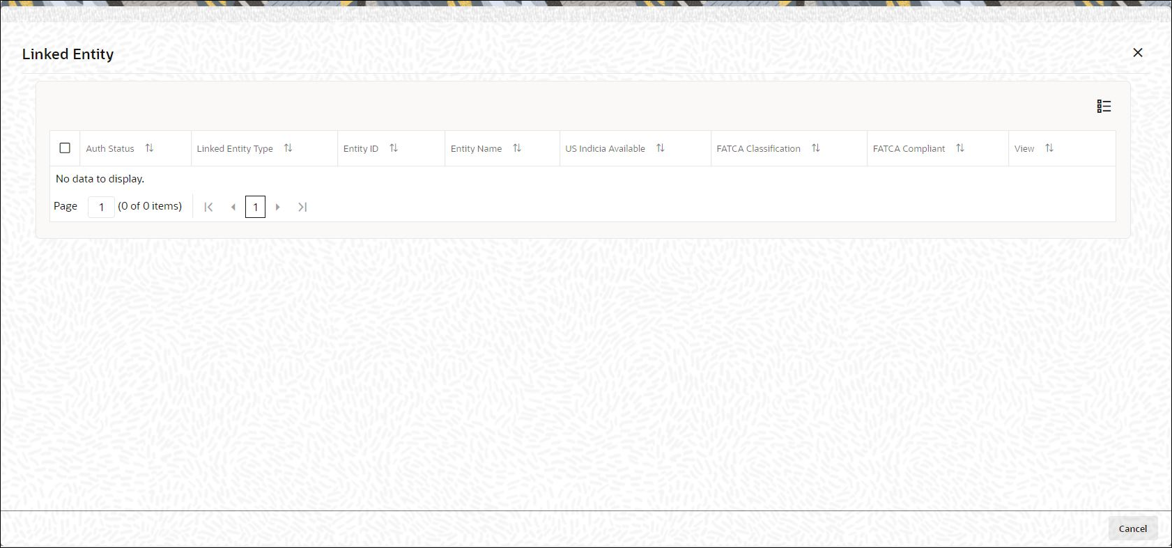

- Click Linked Entity button to view linked entity
details.The Linked Entity screen is displayed.
Figure 6-2 Entity FATCA Classification Maintenance Detail_Linked Entity Button
The system displays the following values:
- Auth Status
- Linked Entity Type
- Entity ID
- Entity Name
- US Indicia Available
- FATCA Classification
- FATCA Compliant
- Click View to view the details of FATCA Maintenance of a
linked entity.
