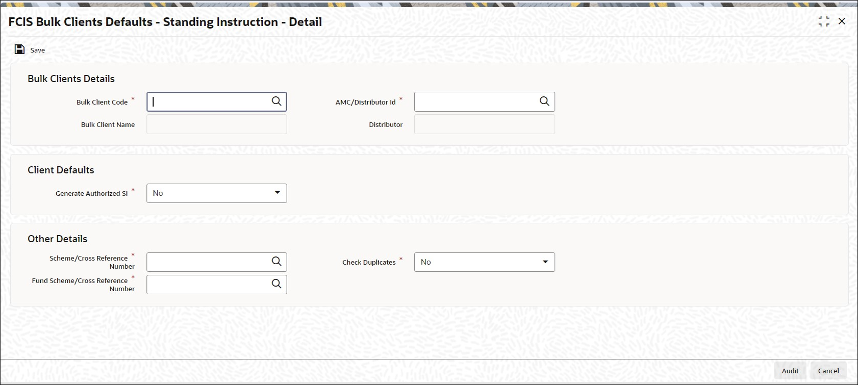

- On Home screen, type UTDBLKSI in the text box, and click Next.The FCIS Bulk Clients Defaults - Standing Instruction - Detail screen is displayed.
Figure 4-16 FCIS Bulk Clients Defaults - Standing Instruction - Detail

- On FCIS Bulk Clients Defaults - Standing Instruction - Detail screen, click New to enter the details.For more information on fields, refer to the field description table.
Table 4-10 FCIS Bulk Clients Defaults - Standing Instruction - Detail - Field Description
Field Description Bulk Clients Details The section displays the following fields.
Bulk Account Client Code Alphanumeric; 12 Characters; Mandatory Specify the bulk account client code.
Bulk Client Name Display The system displays the bulk client name for the selected bulk account client code.
AMC/Distributor ID Alphanumeric; 12 Characters; Mandatory Specify the distributor ID.
Distributor Display The system displays name of the distributor for the selected distributor ID.
Client Defaults The section displays the following fields.
Generate Authorized SI Mandatory SelectYes
from the drop-down list if authorized SI has to be generated. The options available in the drop-down are as follows:- Yes
- No
Other Details The section displays the following fields.
Scheme/Cross Reference Number Alphanumeric; 12 Characters; Mandatory Specify the scheme or cross reference number. Alternatively, you can select scheme or cross reference number from the option list.
This option list will fetch the add info details for the entity add info for unit holder as well as unit holder ID and UH reference number.
Fund Scheme/Cross Reference Number Alphanumeric; 60 Characters; Mandatory Indicates the param value for the param code FUNDSCHEMECROSSREFTYPES.
Check Duplicates Mandatory SelectYes
from drop-down list if check duplicates are available. The options available in the drop-down are as follows:- Yes
- No
