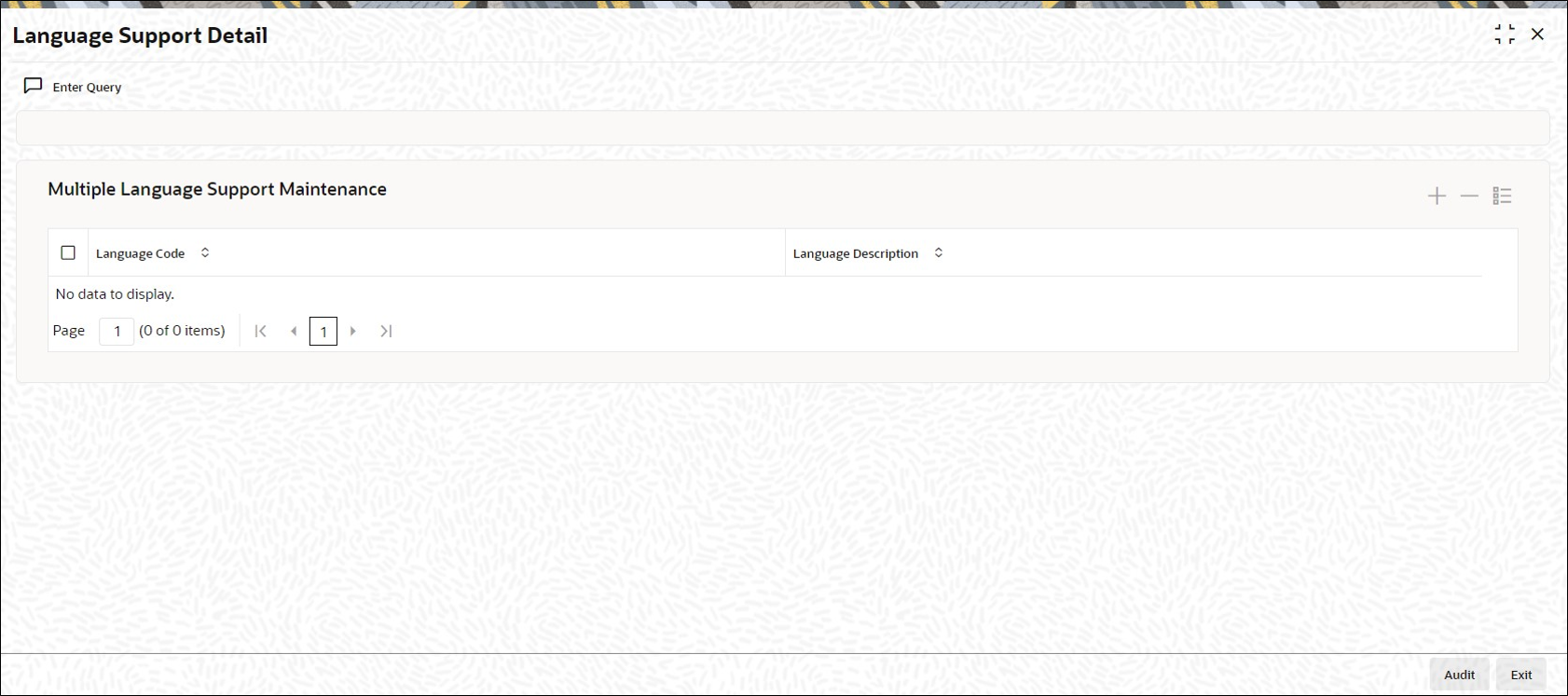

Oracle® FLEXCUBE Investor Servicing provides the facility to maintain multiple languages in the system. You may select different languages at the time of installation. However, you may select additional languages at a later stage. Existing information entered in the default language gets copied to all the languages selected.
The Language Support Detail screen allows you to select languages in which information is stored in the system apart from the default English language.
A list of factory shipped languages is provided. You may select the language codes that the system should support. You can capture information such as the currency name, fund name, etc. in the languages chosen in this screen.
The Language Support Detail screen can be used for the following operations on multiple languages:
- Retrieval for viewing
- Selecting additional language codes
- Editing an unauthorized language selection
- Authorizing language codes selected
- Amending authorized language selections
