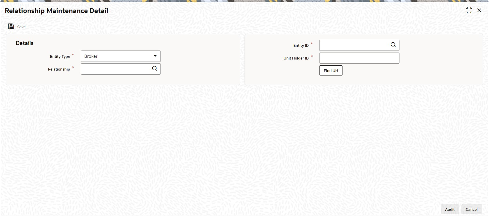

- On Home screen, type UTDENTRL in the text box, and click Next.The Relationship Maintenance Detail screen is displayed.
Figure 2-18 Relationship Maintenance Detail
- On Relationship Maintenance Detail screen, click New to enter the details.For more information on fields, refer to the field description table.
Table 2-13 Relationship Maintenance Detail - Field Description
Field Description Entity Type Mandatory
Select the type of entity from the drop-down list. The list displays the following values:- Broker
- Unit Holder
Relationship Alphanumeric; 2 Characters; Mandatory
Specify the relationship status. Alternatively, you can select relationship status from the option list. The list displays all valid relationship status maintained in the system.
Entity ID Alphanumeric; 12 Characters; Mandatory Specify the entity ID. Alternatively, you can select entity ID from the option list. The list displays all valid entity ID maintained in the system.
Unit Holder ID Alphanumeric; 12 Characters; Mandatory Specify the unit holder ID.
- Click Find UH button to inquire for unit holder ID.
