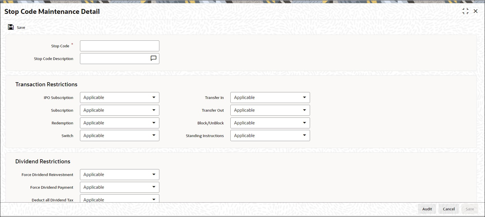

- On Home screen, type UTDSTOPC in the text box, and click Next.The Stop Code Maintenance Detail screen is displayed.
- On Stop Code Maintenance Detail screen, click New to enter the details.For more information on fields, refer to the field description table.
Table 3-15 Stop Code Maintenance Detail - Field Description
Field Description Stop Code Alphanumeric; 25 Characters; Mandatory Specify the stop code.
Stop Code Description Alphanumeric; 255 Characters; Optional Specify the description for the stop code.
Transaction Restrictions The section displays the following fields.
IPO Subscription Optional Select IPO Subscription transaction restrictions from the adjoining drop-down list. Following are the options available:- Applicable
- Not Applicable
- Applicable with Warning
Subscription Optional Select Subscription transaction restrictions from the adjoining drop-down list. Following are the options available:- Applicable
- Not Applicable
Redemption Optional Select redemption transaction restrictions from the adjoining drop-down list. Following are the options available:- Applicable
- Not Applicable
If you select Not Applicable and you try to map the relevant stop code to the UH, then the system will stop the Redemption payment generation for the UH.
If you generate payment for Redemption with restriction as Not Applicable, then the system will display an error message stating generating payment is restricted.
Redemption transactions which requires confirmations will not be available to confirm in confirm redemption batch if Redemption Payment is restricted for the UH.
Switch Optional Select switch transaction restrictions from the adjoining drop-down list. Following are the options available:- Applicable
- Not Applicable
Transfer In Optional Select transfer in transaction restrictions from the adjoining drop-down list. Following are the options available:- Applicable
- Not Applicable
Transfer Out Optional Select transfer out transaction restrictions from the adjoining drop-down list. Following are the options available:- Applicable
- Not Applicable
Block/UnBlock Optional Select block/unblock transaction restrictions from the adjoining drop-down list. Following are the options available:- Applicable
- Not Applicable
Standing Instructions Optional Select standing instruction transaction restrictions from the adjoining drop-down list. Following are the options available:- Applicable
- Not Applicable
Note:- If Standing Instructions is Not Applicable, then it will Pause the existing SI and will disallow the new ones.
- If Standing Instructions is Applicable, then it will allow the new SI and Pause SI (if any) will be restarted.
In case for a particular transaction type, restriction is Not Applicable, then the system will display an error message as STOPACCOUNT is issued for ‘Transaction Type’ to this Unit Holder stating this transaction is restricted.
In case for a particular transaction type, restriction is Applicable with Warning, then the system will display a warning message as STOPACCOUNT is issued for ‘Transaction Type’ to this Unit Holder stating this transaction is restricted. You can override the warning message.
Dividend Restrictions The section displays the following fields.
Force Dividend Reinvestment Optional Select the force dividend reinvestment restrictions from the adjoining drop-down list. Following are the options available:- Applicable
- Not Applicable
If the relevant Stop Code where restriction is applied for Forced Dividend Reinvestment is mapped to the Unit Holder, the system will reinvest the dividend distribution irrespective of UH IDS maintenance.
Force Dividend Payment Optional Select the force dividend payment restrictions from the adjoining drop-down list. Following are the options available:- Applicable
- Not Applicable
If the relevant Stop Code where restriction is applied for Forced Dividend Payout is mapped to the Unit Holder, system will Payout the dividend distribution irrespective of UH IDS maintenance.
Deduct all Dividend Tax Optional Select the dividend tax restrictions from the adjoining drop-down list. Following are the options available:- Applicable
- Not Applicable
If the relevant Stop Code where restriction is applied for Deduct All Dividend Tax is mapped to the Unit Holder, system will Payout the dividend distribution irrespective of UH IDS maintenance.
Payment Restrictions The section displays the following fields.
Redemption Payout Optional Select the redemption payment restriction from the adjoining drop-down list. Following are the options available:- Applicable
- Not Applicable
If you select Redemption Payout field as Not Applicable, and the relevant Stop code is mapped to the UH, then the system will stop the Redemption payment generation for the UH.
If you try to generate payment for Redemption with this status, then the system will display an error message stating generating payment is restricted.
Dividend Payout Optional Select the dividend payment restriction from the adjoining drop-down list. Following are the options available:- Applicable
- Not Applicable
If you select Dividend Payout field as Not Applicable, and the relevant Stop code is mapped to the UH, then the system will stop the dividend payment generation for the UH. If you try to generate payment for a dividend with this status, then the system will display an error message stating generating payment is restricted.
The system will use these restrictions in EFT file generation for Redemptions and Dividend Payments. Check Payments and Transfer will be restricted based on Payment restrictions. Upon release of the Payment restrictions, the system will generate all the pending Dividend and Redemption payments individually.
