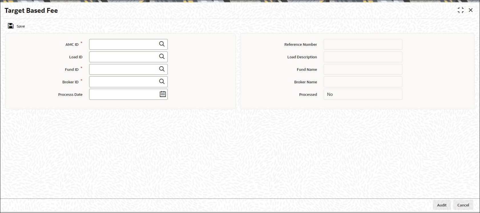

  1. On Home screen, type UTDTGBFE in the text box, and click Next.
    The Target Based Fee screen is displayed.
  2. On Target Based Fee screen, click New to enter the details.
    Table 7-20 Target Based Fee - Field Description
    Field Description
    AMC ID Alphanumeric; 12 Characters; Mandatory
    Specify the AMC. You can also select the AMC for target based fee from the adjacent option list. The list displays all the valid authorized values maintained in the system.
    You can select ALL option if you want to select all the valid AMC maintained in the system.
    Load ID Numeric; 5 Characters; Mandatory
    Specify the Load. You can also select the load from the adjacent option list. The authorized loads having the Slab Mode option selected as Date Amount will be displayed in the option list.
    Load Description Display
    The description of the selected load is displayed.
    Fund ID Alphanumeric; 6 Characters; Mandatory
    Specify the fund. You can also select the fund from the adjacent option list. The list displays all the valid authorized values maintained in the system.
    You can select ALL option if you want to select all the valid funds maintained in the system.
    Fund Name Display
    The description of the selected fund is displayed.
    Broker ID Alphanumeric; 12 Characters; Mandatory
    Specify the broker ID. You can also select the broker from the adjacent option list. The list displays all the valid authorized values maintained in the system.
    You can select ALL option if you want to select the entire valid broker maintained in the system.
    Broker Name Display
    The description of the selected broker is displayed.
    Process Date Date Format; Mandatory
    Specify the processing date. The target based brokerage is processed on this date. If the date maintained here is a system holiday, then the system will process the brokerage only on the next working day.
    Reference Number Display
    On saving the transaction, a unique reference number is generated.
    Processed Display
    The system displays Yes value if the transaction is processed on the processed date.
