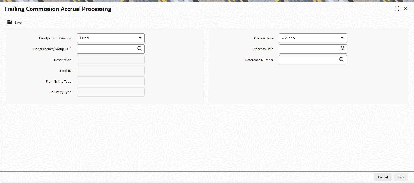

7.14 Process Trailing Commission Accrual Processing
The accrual of trailer commission for a fund or group of funds can be executed as a job, which you can trigger in the Trailing Commission Accrual Processing screen.
  1. On Home screen, type UTDTCAC in the text box, and click Next.
    The Trailing Commission Accrual Processing screen is displayed.
    Figure 7-19 Trailing Commission Accrual Processing
  2. On Trailing Commission Accrual Processing screen, click New to enter the details.
