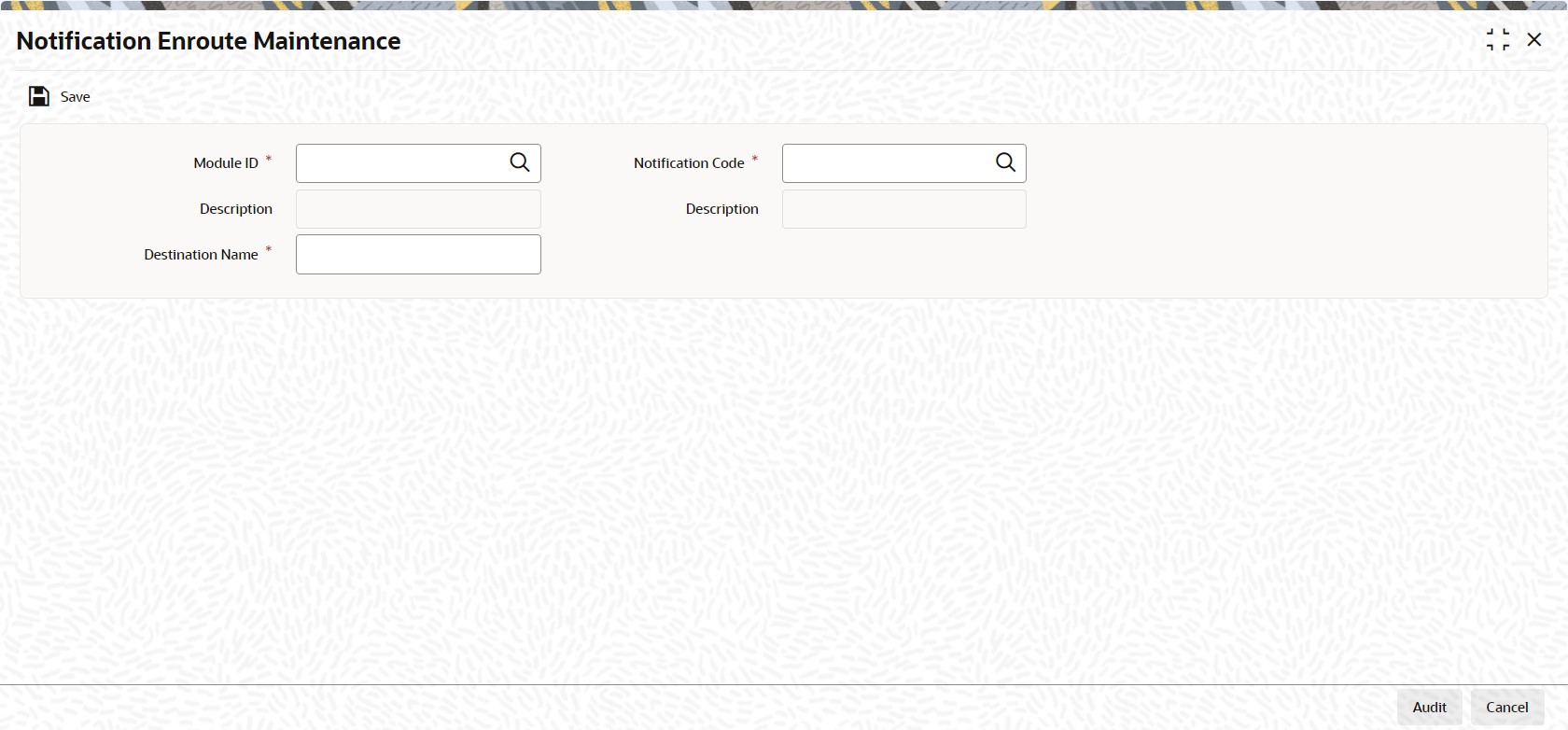

This topic provides the systematic instructions to set up notification queue at the module level.
You can set up notification queue at module level using Notification Enroute Maintenance screen. Notification job will look into the SMS data store for any pending activity and depending upon the module code call will be made to respective LOB to build response xml and place it in the maintained notification queue for that module.
  1. On Home screen, type UTDNTFEN in the text box, and click Next.
    The Notification Enroute Maintenance screen is displayed.
    Figure 3-17 Notification Enroute Maintenance
  2. On Notification Enroute Maintenance screen, click New to enter the details.
    Table 3-10 Notification Enroute Maintenance - Field Description
    Field Description
    Module ID
    Alphanumeric; 30 Characters; Mandatory
    Specify the module ID. Alternatively, you can select module ID from the option list. The list displays all valid module ID maintained in the system.
    Description
    Display
    The system displays the description for the selected module ID.
    Notification Code
    Specify the notification code. Alternatively, you can select modification code from the option list. The list displays all valid notification code maintained in the system.
    Description
    Display
    The system displays the description for the selected notification code.
    Destination Name
    Alphanumeric; 100 Characters; Mandatory
    Specify the destination name.
