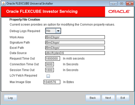

1.1 Set Up Common Properties
This topic describes the process of setting common properties of Scheduler.
- You can choose an option for modifying the common property
values.The following screen is displayed.
- On Common Property Values screen, enter
the following details.Refer to the table for Common Properties.
Table 1-2 Common Property Values
Field Description Debug Logs Required Select Yes from the drop-down list if you require debug option. If you do not require debug option, select No.
Work Area Specify the work area.
For example: D:\BrnDbgs\
Signature Path Specify the location at which the signature images will be placed.
Excel Path Specify the location at which the excel files will be generated.
Data Source Specify the JNDI location which points to SMS schema. The standard format is jdbc/fcisdevDS.
Request Time Out Specify the database request time out value in seconds. This is the maximum number of seconds the database will wait for a query to return the result.
Connection Time Out Specify the database connection time out value in seconds. This is the maximum number of seconds the application will wait for a connection to the database to open.
LOV Fetch Required If you check this box, the option lists in Oracle FLEXCUBE will display the matching values based on the first characters that you enter in a field.
That is, if you specify the first three characters of a value to be entered in an option list, the system will display the complete list of values that are matching the first three characters.
If you do not check this box, the option lists will not display the matching values based on the first few characters. You need to specify the complete value against the field.
Max Image Size Specify the maximum image size in bytes.
