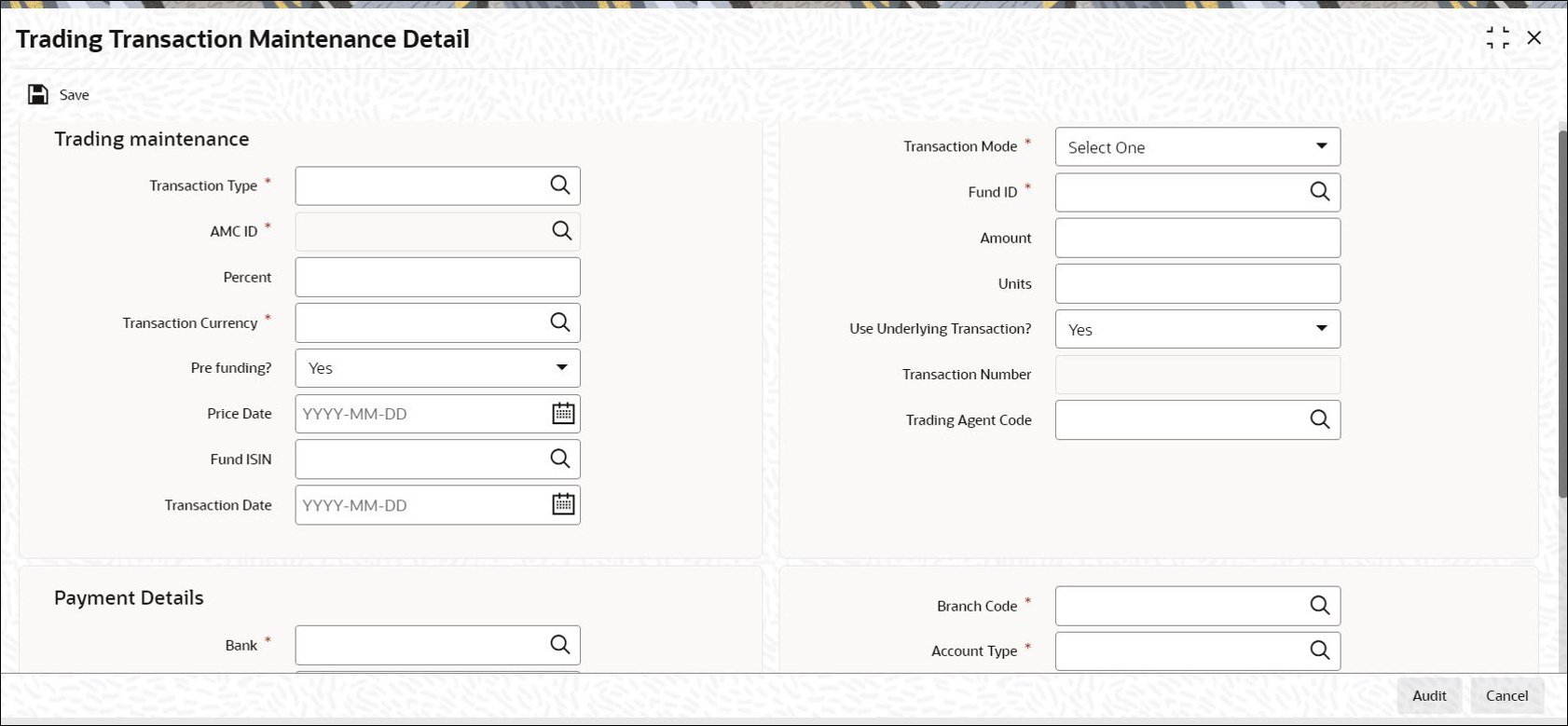

This topic provides the systematic instructions to initiate any of the trading transactions in the system.
- On Home screen, type UTDTRDTX in the text box, and click Next.The Trading Transaction Maintenance Detail screen is displayed.
Figure 1-4 Trading Transaction Maintenance Detail

- On Trading Transaction Maintenance Detail screen, click New to enter the details.For more information on fields, refer to the field description table.
Table 1-5 Trading Transaction Maintenance Detail - Field Description
Field Description Trading Maintenance This section displays the following details. Transaction Type Alphanumeric; 2 Characters; Mandatory

By default, the price date is reckoned to be the application date. In such a case, the prevalent price as on the application date need not be available at the time of initiating the trading transaction in this screen, but it must be available when the authorization of the trading transaction is done.
