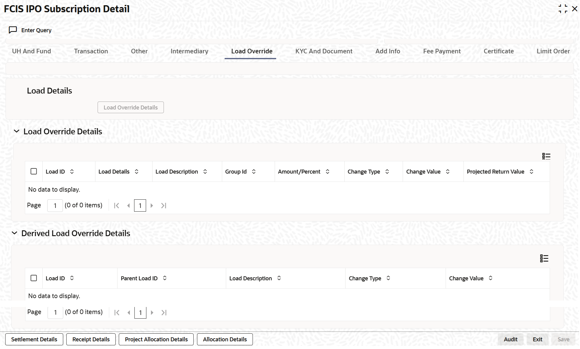

3.4.6 Load Override Tab
This topic explains the Load Override tab of FCIS IPO Subscription Detail.
In this section, you can override or alter the value of any load (including derived
loads, if any) mapped to the selected fund and applicable for the transaction type,
which is to be computed at the time of allocation. The frequency of computation for
such loads would be Allocation.
This section is only enabled for funds that have allocation time loads mapped to them as applicable for the transaction type.
If you click Load Override Details button, the system defaults the load details.
If you do not click this button, then the system will not default even if the fund has load. In this case, load will get computed during allocation only.
