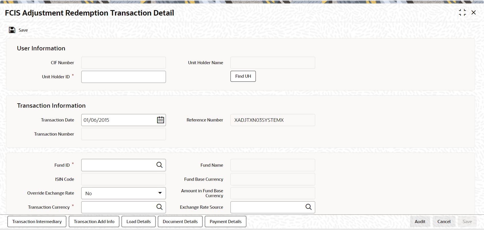

  1. On Home screen, type UTDADJ03 in the text box, and click Next.
    The FCIS Adjustment Redemption Transaction Detail screen is displayed.
    Figure 5-1 FCIS Adjustment Redemption Transaction Detail
  2. On FCIS Adjustment Redemption Transaction Detail screen, specify the fields.
    For more information on fields, refer the field description table.
