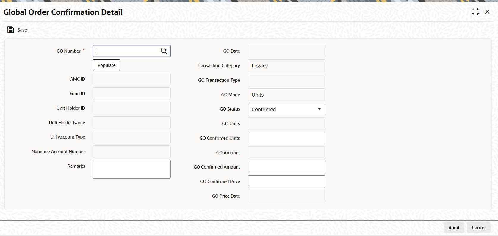

- On Home screen, type UTDGOCNF in the text box, and click Next.The Global Order Confirmation Detail screen is displayed.
Figure 4-8 Global Order Confirmation Detail
- On Global Order Confirmation Detail screen, click New to enter the details.For more information on the fields, refer to the field description table.
Table 4-12 Global Order Confirmation Detail - Field Description
Field Description Global Order Number Alphanumeric; 16 Characters; Mandatory Specify the Global Order number.
If you click on Populate button, the following fields are displayed.
AMC ID Display The system displays the AMC ID.
Fund ID Display The system displays the fund ID.
Unit Holder ID Display The system displays the unit holder ID.
Unit Holder Name Display The system displays the unit holder name.
UH Account Type Display The system displays the UH account type.
Nominee Account Number Display The system displays the nominee account number.
Remarks Alphanumeric; 255 Characters; Mandatory Specify remarks, if any.
Global Order Date Display The system displays the Global Order date.
Transaction Category Display The system displays the transaction category. One of the following values are displayed in this field:
- Legacy
- Advised Business
- Execution Only
Global Order Transaction Type Display The system displays the GO transaction type.
Global Order Mode Display The system displays the GO mode. One of the following values are displayed in this field:
- Unit
- Amount
Global Order Status Optional Select the Global Order status from the drop-down list. Following are the options available in the drop-down list:
- Confirmed
- Rejected
- Pending Confirmation
- Amount Mismatch
- Unit Mismatch
- Price Mismatch
For Amount based order, if confirmation amount is mismatch then system will save record with Status as Amount Mismatch.
For Unit based order, if confirmation unit is mismatch then system will save record with Status as Unit Mismatch.
For Amount/ unit based order, if confirmation price is different than the fund price (for transaction date and transaction type combination) then system will save GO with status as Price Mismatch.
If unit/ amount and confirmation price matches then system will save the GO with confirmed status as Global Order Confirmed.
You can change the GO status manually to either GO confirmed or GO rejected in the GO Confirmation screen. All other statuses are defaulted by the system without manual intervention. Once GO is rejected, post confirmation of rejected order and all underlying transactions in the GO will be rejected. These will not be taken up for allocation.
Global Order Units Display The system displays the Global Order units.
Global Order Confirmed Units Numeric; 27 Characters; Optional Specify the Global Order confirmed units.
Global Order Amount Display The system displays the Global Order amount.
Global Order Confirmed Amount Numeric; 30 Characters; Optional Specify the Global Order confirmed amount.
Global Order Confirmed Price Numeric; 22 Characters; Optional Specify the Global Order confirmed price.
The system will consider the confirmation price received against a GO as the fund price for the GO confirmation date.
Global Order Price Date Display The system displays the Global Order price date.
The Global Order Confirmation Detail screen will support all messages received via Swift Messages and will be enabled for any manual confirmation.
If no confirmation is received from the fund house, then GO will not be reversed, however, it will reflect GO status as Pending Confirmation in Global Order Confirmation Detail screen.
The system will run the pre-EOD batch to check if all GOs generated for the day have been confirmed. The batch will also include unconfirmed GOs for back dated. Only if GO is confirmed, the underlying trades will be allotted.
Parent topic: Process the Transactions - II
