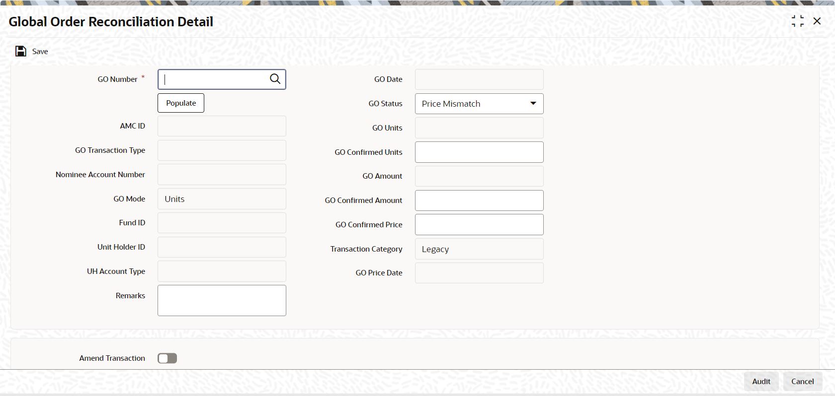

  1. On Home screen, type UTDGORCN in the text box, and click Next.
    The Global Order Reconciliation Detail screen is displayed.
    Figure 4-9 Global Order Reconciliation Detail
  2. On GO Confirmation Detail screen, specify the fields.
    For more information on fields, refer to the field description below table.
    Table 4-13 Global Order Reconciliation Detail
