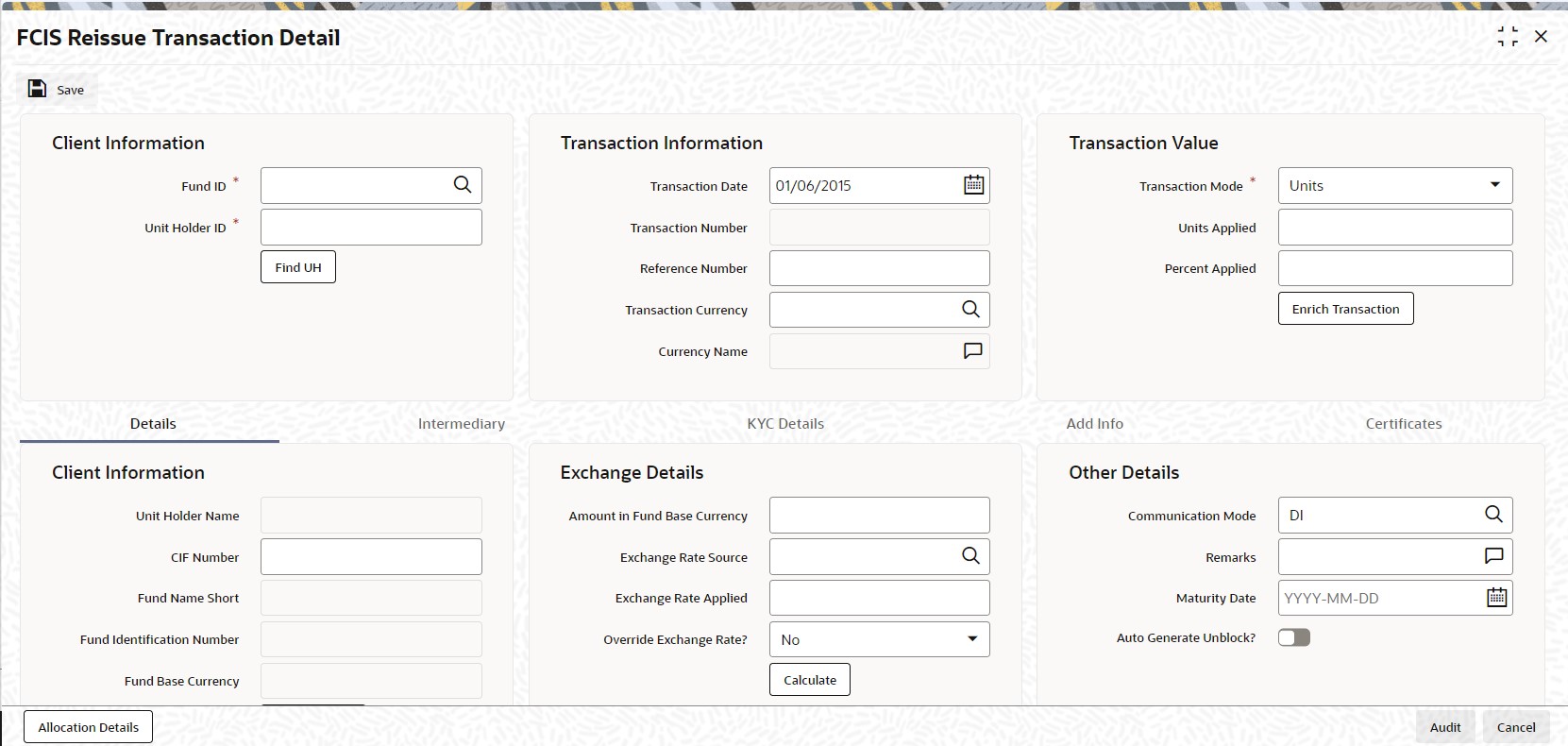

3.29.1 Process Reissue Transactions Detail Screen
This topic provides the instructions to enter a block transaction request into the system.
  1. On Home screen, type UTDTXN10/UTDTRA10 in the text box and click Next.
    The FCIS Reissue Transaction Detail screen is displayed.
    Figure 3-136 FCIS Reissue Transaction Detail
  2. On FCIS Reissue Transaction Detail screen, specify the fields.

  3. Click the Enrich Transaction button after entering all details in Transaction Information section.
    The list of transactions applicable for the Unit Holder selected is defaulted in UH and Fund section.
