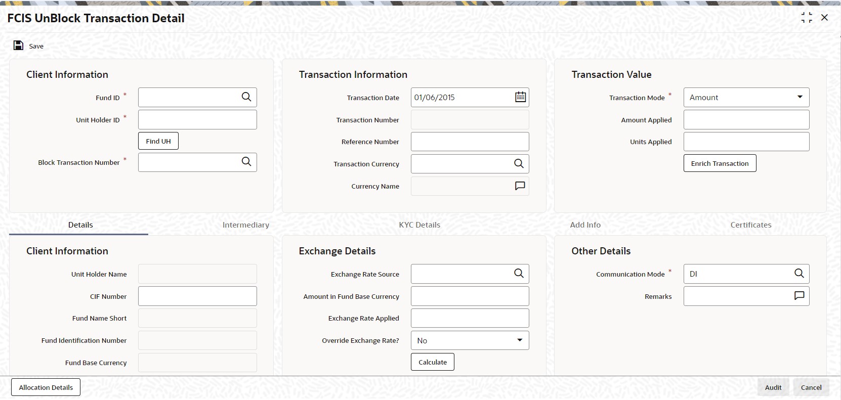

- On Home screen, type
UTDTXN07/UTDTRA07 in the text box and then click
Next.The FCIS Unblock Transaction Detail screen is displayed.
Figure 3-109 FCIS Unblock Transaction Detail
- On the FCIS Unblock Transaction Detail screen, specify the fields.
For more information on fields in the screen, refer the below table.
Table 3-125 FCIS Unblock Transaction Detail
