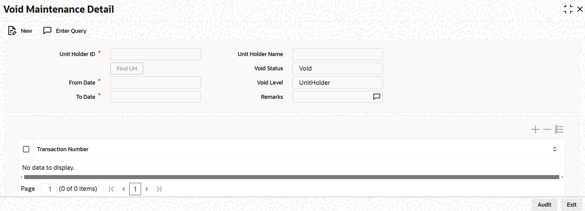

  1. On Home screen, type UTDVOID in the text box, and click Next.
    The Void Maintenance Detail screen is displayed.
    Figure 4-16 Void Maintenance Detail
  2. On Void Maintenance Detail screen, specify the fields.

    Table 4-22 Void Maintenance Detail
    Fields Description
    Unit Holder ID Alphanumeric; 12 Characters; Mandatory
    Specify the unit holder ID. You can also click on ‘Fund UH’ button to select the valid unit holder ID.
    Unit Holder Name Display
    The system displays the unit holder name for the selected unit holder ID.
    From Date Date Format; Mandatory
    Select the date from when the void details needs to be maintained from the adjoining calendar.
    To Date Date Format;
    Select the date till when the void details needs to be maintained from the adjoining calendar.
    Void Status Optional
    Select the void status the drop-down list. The list displays the following values:
    • Void
    • Un-Void
    Void Level Optional
    • UnitHolder
    • Transaction
    Remarks Alphanumeric; 255 Characters; Optional
    Specify remarks, if any
    Transaction Number Alphanumeric; 16 Characters; Optional
    Specify the transaction number, Alternatively, you can select transaction number from the option list. The list displays all valid transaction number maintained in the system.
