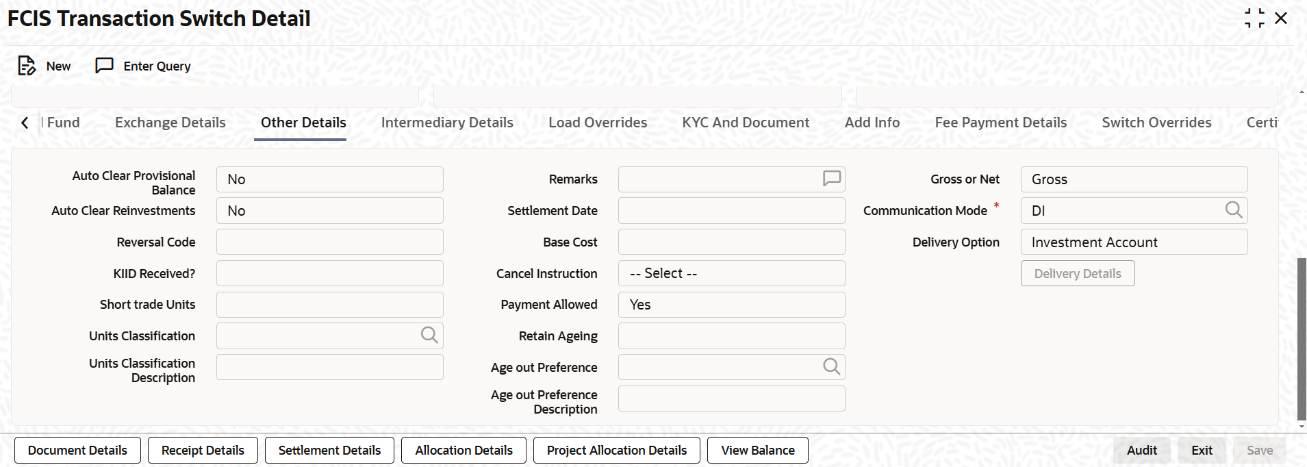

3.16.4 Other Details
This topic explains the Other Details tab in the FCIS Transaction Switch Detail screen.
  1. Click Other Details tab in the FCIS Transaction Switch Detail screen.
    The Other Details are displayed.
    Figure 3-67 FCIS Transaction Switch Detail screen - Other Details
  2. On Other Details tab, specify the fields.
    Table 3-90 FCIS Transaction Switch Detail - Other Details Tab
