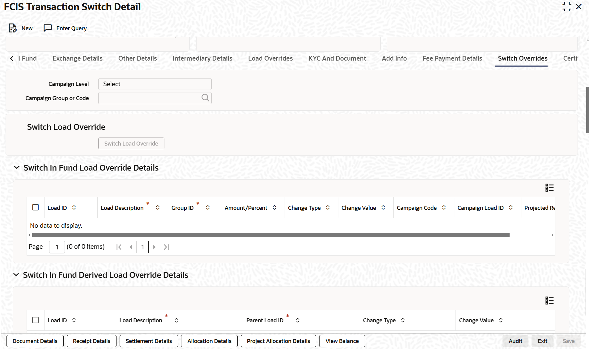

3.16.10 Switch Overrides Tab
This topic explains the Switch Overrides tab in the FCIS Transaction Switch Detail screen.
  1. On the FCIS Transaction Switch Detail screen, click Switch Overrides tab to enter the details.
    The Switch Overrides details are displayed.
    Figure 3-73 FCIS Transaction Switch Detail - Switch Overrides
  2. On Switch Overrides tab, specify the fields.
    Table 3-97 FCIS Transaction Switch Detail - Switch Overrides Tab

    Switch Load Override
    Click the Switch Load Override button to view Switch Load Override details.
    Switch In Fund Load Override Details This section displays the following fields.
    Load ID Display
    The ID of the allocation time load that has been mapped to the fund for the transaction type is displayed here. The load ID is displayed as a link. To view details of the load, click the ID link.
