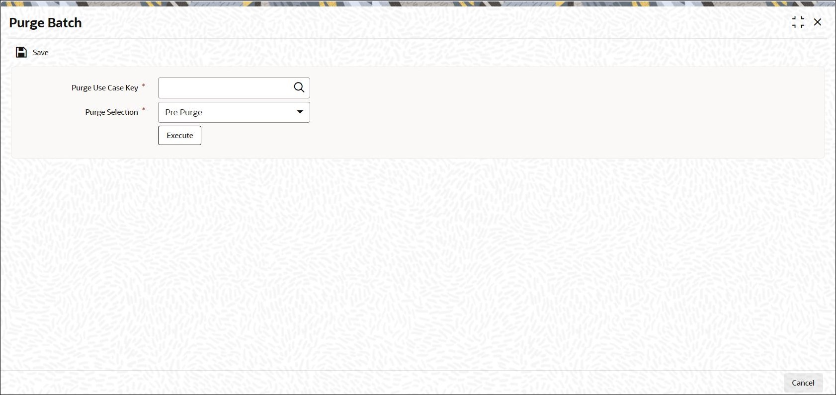

- On Home screen, type UTDPURBT in the text box, and click Next.The Purge Batch screen is displayed.
- On Purge Batch screen, click New to enter the details.For more information on fields, refer to the field description table.
Table 1-4 Purge Batch - Field Description
Field Description Purge Use Case Key Alphanumeric; 60 Characters; Mandatory
Specify the purge use case key. Alternatively, you can select purge use case key from the option list. The list displays all valid purge use case key maintained in the system.
Purge Selection Mandatory
Select the purge status from the drop-down list. The list displays the following values:- Pre Purge - A pre purge procedure will run (either manual or during EOD) and will populate relevant records picked up by the pre purge procedure for purge/archival
- Post Purge - The post-purge process will run manually or automatically or during EOD for purge/archival. For manual operation, you can use Purge Batch screen and for automatic operation, the same will happen during the authorize button click itself.
Note: Purge keys with pre/post as manual only will be listed in the purge batch screen option list based on the purge selection.

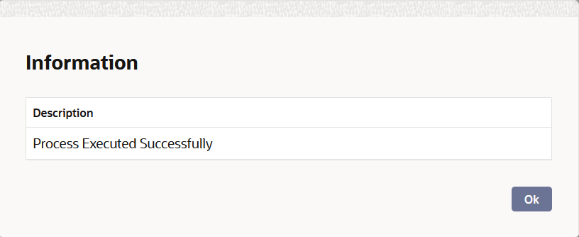

- Click Execute to execute the purge batch. There will be a pre purge procedure which will populate the identified records for authorization. The screen will also identify records which cannot be purged for business reasons.The following information window is displayed.
Figure 1-7 Purge Batch_Information Message
- Authorize the pre purged record.
The system will archive/purge process based on the maintained schedule. The system will also log the detail of records which could not be purged along with reasons.
